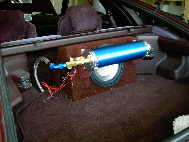

Adjuster
I used two washers and a 10mm nut, but I'd leave out one washer if I did it again as the high rpm oil pressure is pretty high when it's cold. (I'm not sure that with this pump, you could get it too high actually to damage the bearings, but it does cause the turbo to smoke if your pushing too much oil pressure into the CHRA. (Mine was BB, and they don't really need as much oil actually.)
When it's all hot, the stock gauge pressure reading is about 50psi at high rpm, and drops to the 20's during idle.
Cold is 80+ and cold idle at 40+. (My accusump gauge has seen a few 120's on there when I've closed the valve after running the car for a few miles, and the oil is still cold. I generally close the valve during high rpm running to save oil under pressure to pre-lube my engine on start up.)
So, it's up to you, but one 10mm nut, or a few washers about the same thickness as the nut would do just fine. (Assuming your not going to run the stock pressure bypass cooler.)
Adjuster
No, what I did was fill the accusump with oil and the piston all the way down on the gauge side. Then screwed in the valve and fittings, then hooked up the AN10 line to the engine. There is a schrader valve on the gauge side, and I put 10 psi of pressure on the oil to push it out of the sump. (I've since changed that to 5psi when the piston has pushed all the oil out of the sump, and I'm sure it brings up the pressure as the oil pushes the piston across the tube.)
Anyway, before I started this motor, I pre-lubed it with the accusump, then it started right up no issues. :)
I've changed the oil a few times, and I have hit the switch and dumped the oil from the sump, and then had a "dry" start as a result, but I figured a few dry starts is better than changing the oil and then dumping a few quarts of dirty stuff right back into the new oil.
One more detail. I'm running 10 quarts of oil now v/s the 12 quarts I started with. When I'd run 12, it was blowing oil out the dipstick at times, and also pushing it out my PCV breather at the drag races... With 10 quarts there is absolutely no problem. The dipstick is "full" when the oil is just at the point where the wire is crimped to the flat metal end. (So about 1.5 quarts fuller than "stock" right? Not counting the oil in the lines, cooler, filters and sump.)

Adjuster
Radious slot? Time per second box? Hello? I'm thinking your running low on blinker fluid, and your muffler bearings are worn out man....
Valve is on my Canton Accusump. It holds a few quarts of oil under pressure that is then forced into the engine if the oil pressure drops below a set point. (Like when your car is speeding up, slowing down, or turning and you slosh the oil off the pickup point.... Your engine never runs without oil pressure.)
Here is where I mounted mine. Makes a nice subwoofer grille...
