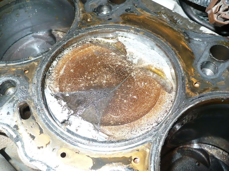

I've seen 0 with a cracked piston, something like this will do it (from recent post by a member):

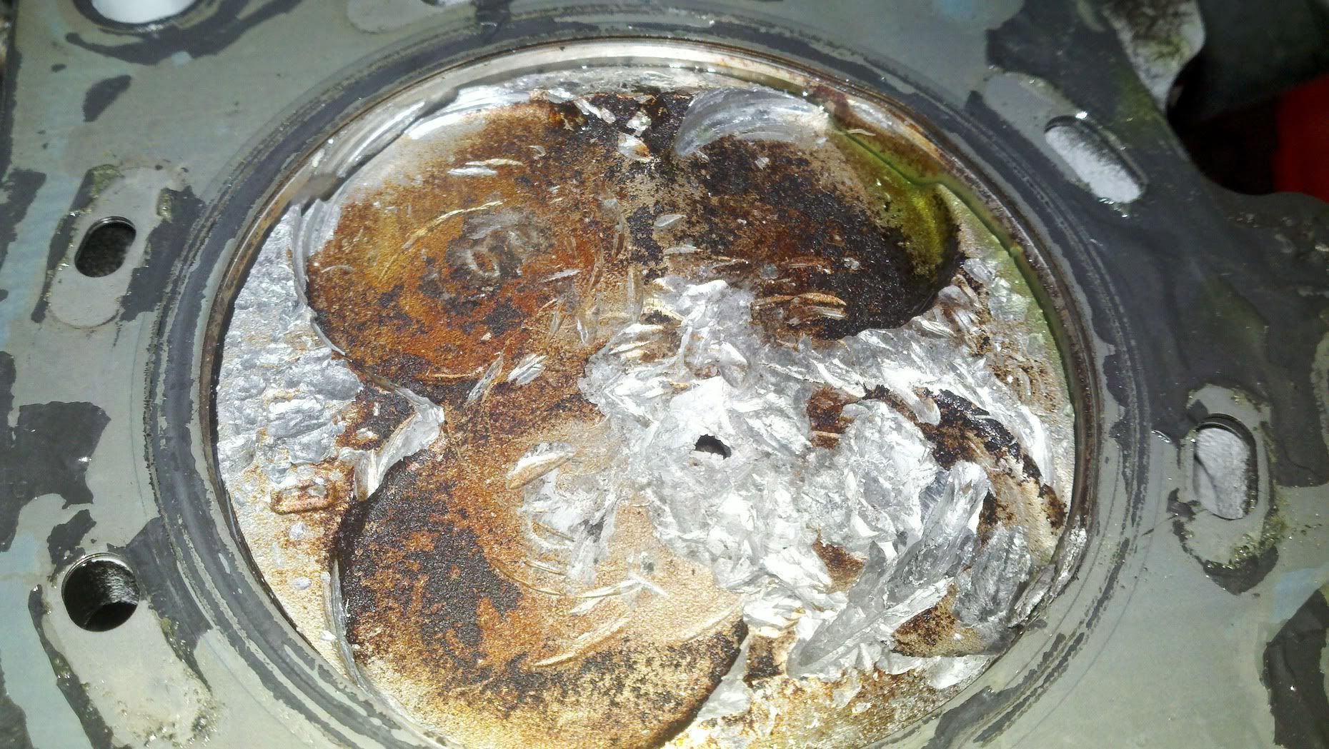

Melted piston will do it too (Friends 2JZ in his MKIV -- serious lean out at high boost on a long high speed highway run) :
But generally you're going to know about both of those long before you whip out the compression tester...
