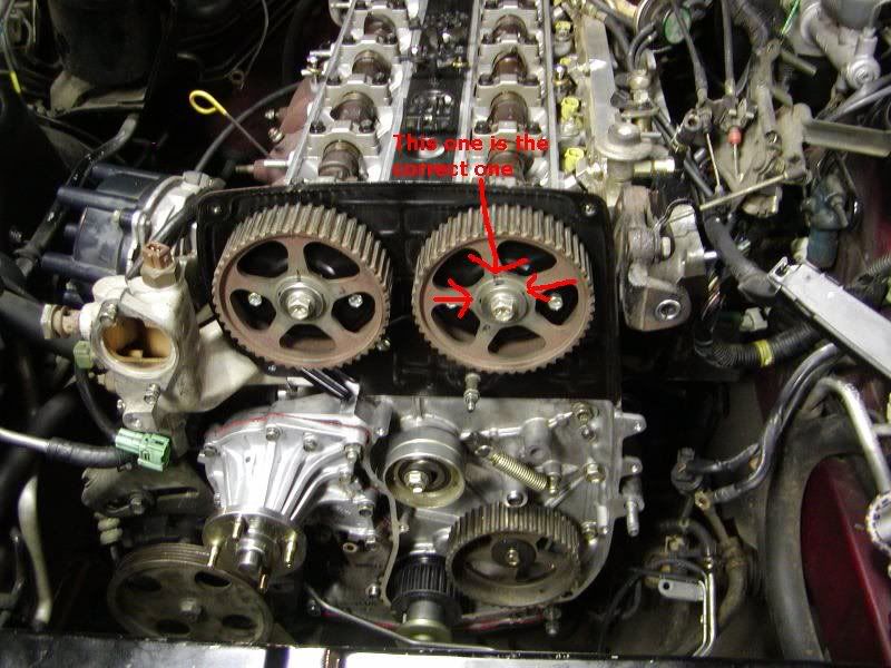

did you ever take out the cams, or take off the cam cogs? There is a alignment pin on each cam behind the screw and washer. It should be in the center hole on the cog. This could distort the timing(If i'm correct?) if it is not in the center one of the 3.
you can barely see them behind the washer in this pic.
