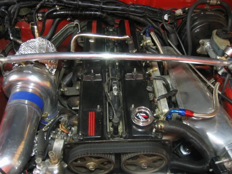

That would be cool, something like I made with louvers?
I just posted pics installed with the brackets in the first post to keep the whole writeup together.

Ideal..... I made them from some stainless I trimmed off making that generic cover, cut the piece out with a cutoff wheel and bent the tabs down.
I'll be happy to see you guys running the setup out there and hear feedback. I wish I was driving my car around but I'm on a mission with some projects:) I am so happy that bump/miss at idle is gone. If anyone else out there has that, and this cures it..... LMK.

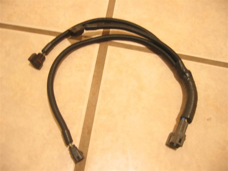

so all you do for the harness is extend the factory coil pack harness(7m) and then it just plugs into the lexus coils. correct?
I am doing this 100% for sure.
Justin
Speakers?
1,699
Spokane, Wa
Yep! Nice and simple.
