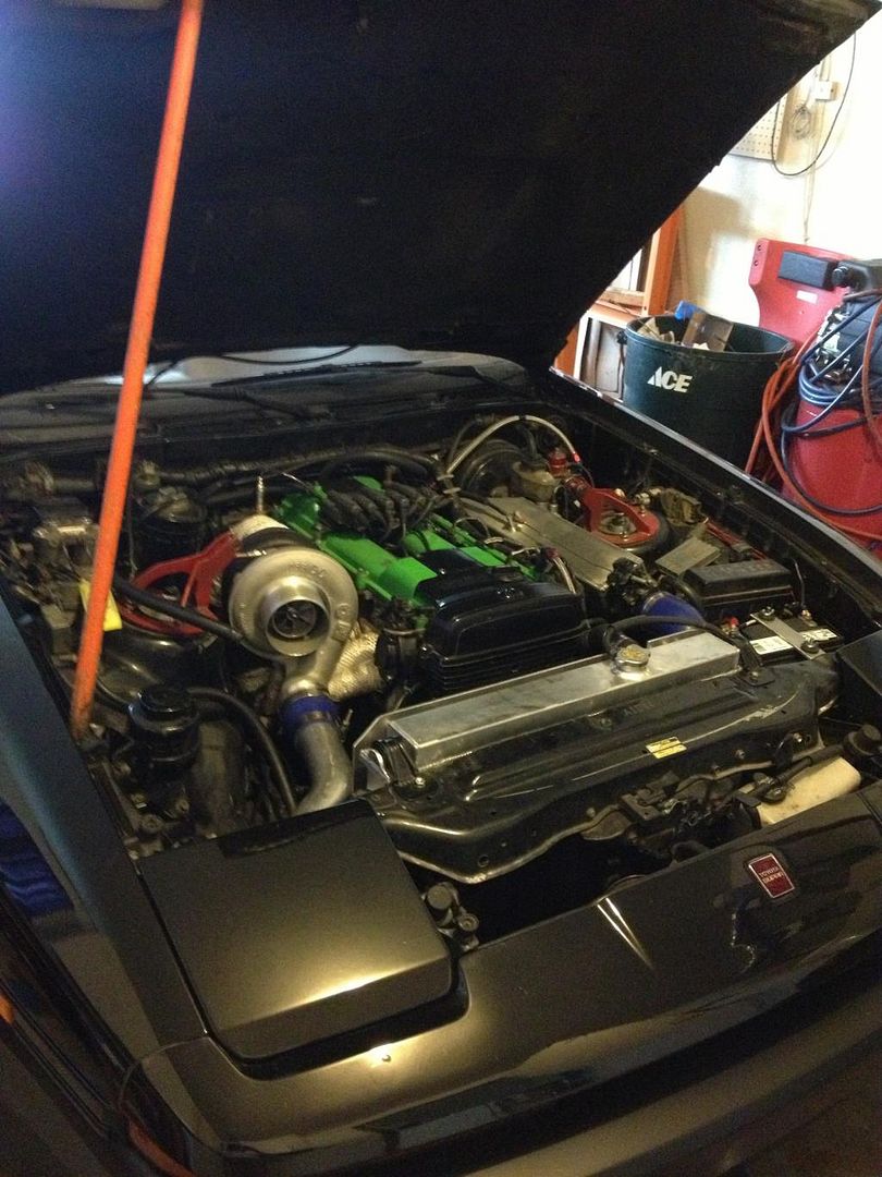

when i was figuring out my na-t build my goal was a responsive setup that could do autox, drags, track days, or just hit the road. at first i wasn't going to go with a ffim but then when i tore down the motor for the tt hg/arp studs i was like im never putting that pos back together. i would dread changing plugs with the stock intake, ic piping is hell, hard to fit large turbo, and it looks like shit. plus the ffim would helped with my build goal.
the 7mgte isn't as bad as the 2jzge but still has similar benefits to going ffim. your understanding is true. i went with 2.5" ic piping, stock throttle body, and ffim with response in mind. the smaller shorter piping is less volume to fill. the stock throttle body is like a hose nozzle. going with a 3" ic piping, gigantic throttle body, ect like some people think will give them more hp is wrong! the only time those help is when you're pushing tons of air like over 700whp. under that all its going to give you is more lag.
i decided to make my own. after researching on a boosted car the long runner and short runner doesn't really matter as much compared to in an n/a motor since once its pressurized its a mute point. people were saying the rear cylinders with ffim by design will get more air and run leaner since the air shoots to the back passing the first ports. to combat that i set up my throttle body to open sideways compared to most on the market open flat. so on part throttle the plate directs air towards those front cylinders. after running the manifold for years now the plugs always look identical the rears never look leaner. my throttle body placement might have helped that but all other cars ive seen with ffim don't seem to have the problem so idk for sure.
really its up to you. you can have a responsive nice setup without one. will going to one make it more responsive yes but not necessary. turbo choice and exhaust housing size is what really is going to determine when you hit full boost and how it pulls to redline. heres a pic of mine

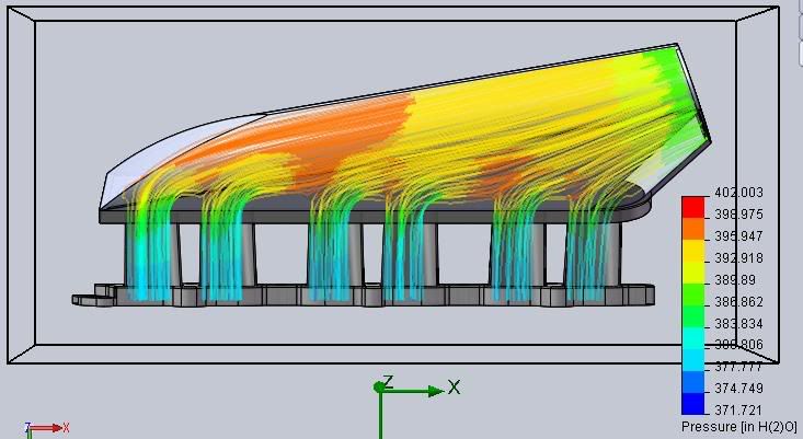

I've seen flow simulation for FFIM that look like this: equal filling:
There is no EGR usually on FFIM, but can be provided as an option sometime.
On stock manifold, it feed the #6, maybe #5 also.
Until the hole is a gallery going to the throttle body (I don't know), it's no rocket sience to understand gaz entering here won't go to the firsts cylinders, because air mass and flow from TB to valves is stronger.

Computer simulations may not exactly represent real situations.
That is why you make a huge plenum/manifold so that air will always be distributed equally at a specific resonating frequency tuned towards the RPM band target (ideally), and it does with race manifolds. The amount of air flow and the harmonic frequencies made inside the manifold, both play a role in how long the runners should be in relation to plenum size, in order to get the most power.
Not all intake manifolds are made equal. A+ to making your own, I wish I tried. Maybe next time ;)

Yes, computer simulations may not exactly represent real situations. The one I posted is from Sethron's manifold, who made several simulations to optimise plenum volume/form factor.

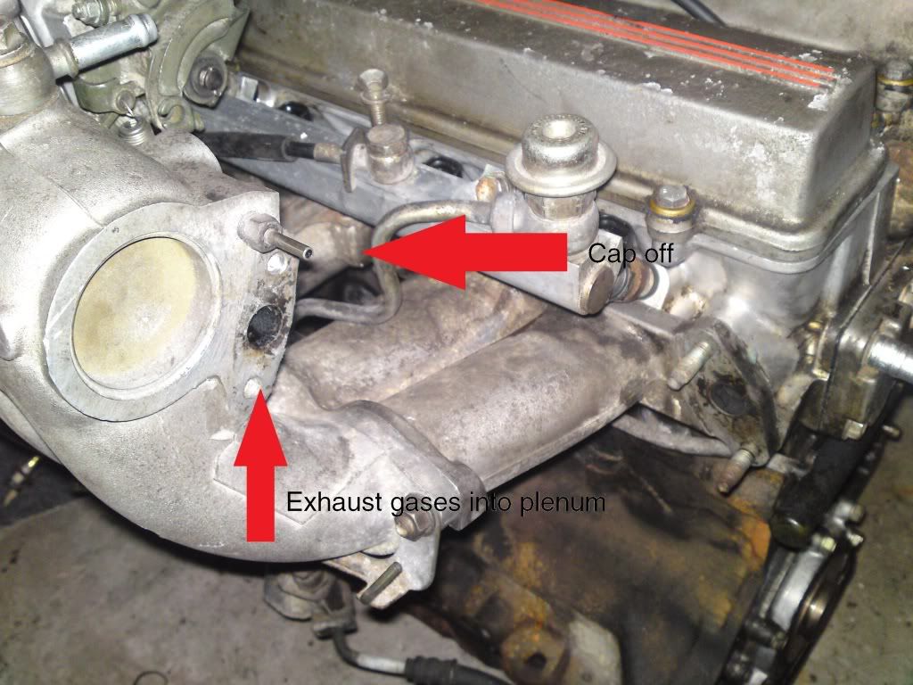

Actually it seems to be a gallery so all cylinders may be feed:
BHG happens anywhere I think, but usually between two of the three last cylinders. I made a bhg between 3&4 with egr blocked, so I would assume it's not related

Interesting. The hose nozzle likeness makes sense. I'm currently running 2.5 hardpipes myself albeit still on stock pipe routing. Really I'm not looking to push the boundaries that much, possibly high 300's-low 400's.This project is going to be mostly sliding sideways, so high horsepower isn't really necessary. With limited rpm's on the 7M I figured that torque and response would be more important by putting more emphasis of the powerband at lower revs. Unless I'm going about this the wrong way, please correct me :)
Interesting concept of setting your throttle body sideways like that. First I've see of that type of design from other 7M's I've seen, nice setup btw!

Take a look inside the plenum some time. If it only flowed into cylinder 6 and 5 then it would not do its job.
