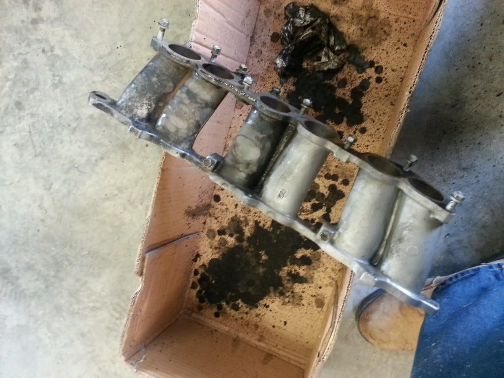

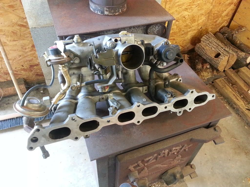

For the sake of entertainment, this is how I spent the last day of break!
Carefully reconstructed for the sake of remembering where shit goes haha
Cleaned all gasket surfaces and scrubbed the hell out of the intake runners as well as the trottle body, just waiting on new gaskets now.

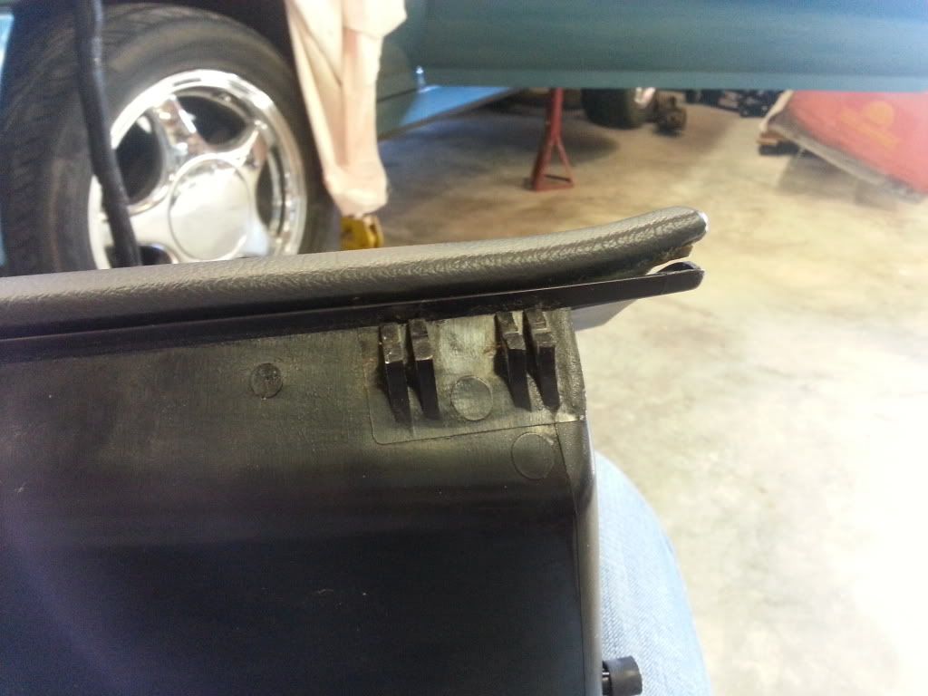

Well this sucks, both sets of tabs on the glove box were snapped off when I got it removed.
Should I fab new mounts or just get a new box ($$)? Lock mechanism works fine and it still looks fine.

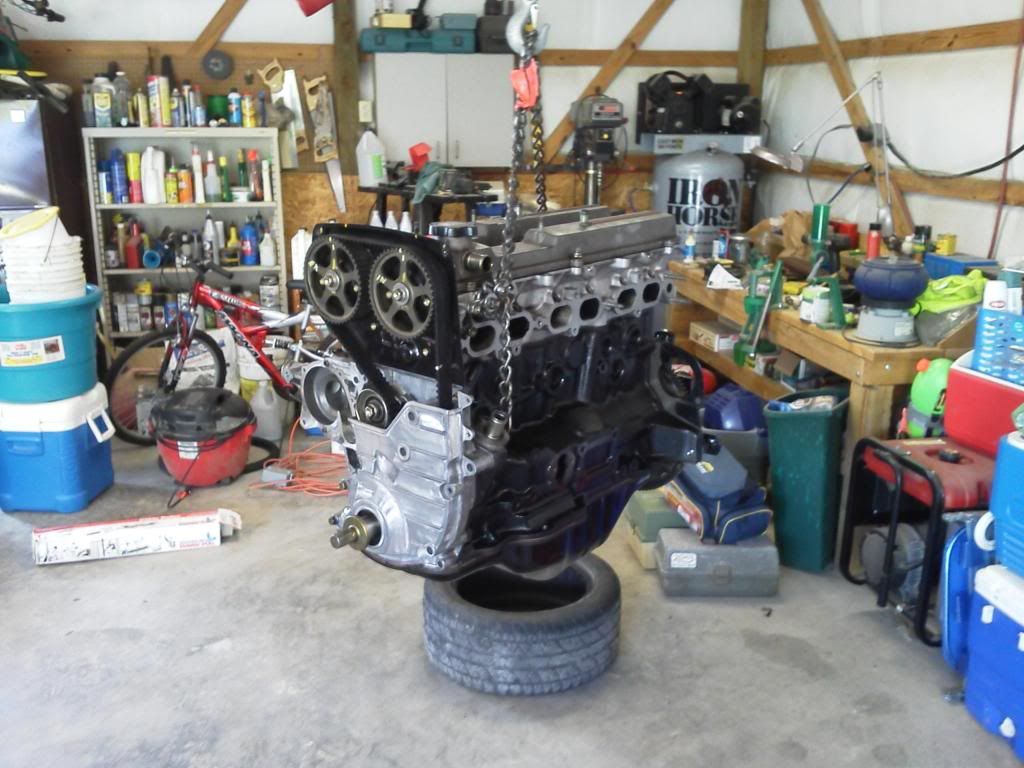

Rebuild is DONE! Old man that took it apart said sludge was so deep in the oil pan there was an indent from the pickup tube, it's a wonder nothing got cooked when I first test drove the car. The sludge starved the bottom end and spun only one bearing, but the crank survived. New pistons, rings, bearings, and oil pump later:
