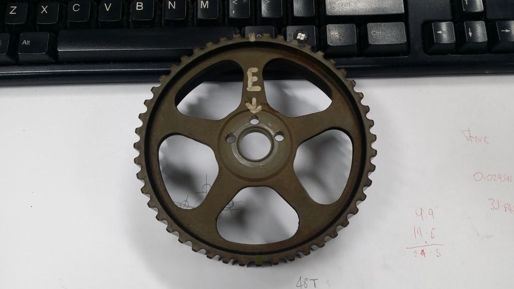

stock cam gear adjust-ability

What if the hole of the camshaft are not perfectly aligned with those of the gear ? Would it provide say -5 / +5?
Gats, you measure 74° apart on the gear, how much do you measure on the camshaft?

This week-end, I will measure the angle between camshaft pin hole, to compare with the 74° from camgears.

Bmettie
Apr 27, 2010
188
Florida
So back on topic...The holes in the cam vs the cam gear are not identical. If you have the pin in the middle hole another one will not go into the side holes, you'll have to remove the center pin and roll the gear forward or back to get one of the side holes, hence the slight adjustability.
