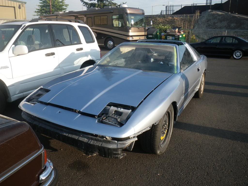

Here's a quick summary in pictures. June 20th, a brand new Ford Explorer and my Supra's rear bumper have an unfortunate encounter. Insurance company quotes over $7k in damages!! "Totals" my car, of course, since all they see is "old Toyota" with fading paint, half missing interior, and almost 200k on the clock.
The sheet metal is badly crumpled, but miraculously, the frame is perfectly straight!! I decide that I can't desert my Supra (after all, it had just sacrificed itself to keep me safe from harm, so now it was up to me to save it from being junked), and so I "buy it back" less my deductible, from the insurance company. Now, I have a budget to get this car back on the road asap so that I can at least take one cruise around the Gorge with the targa off.

Moldy, mossy, smelly, missing diff and trans, and... not pretty, but the rear end was straight. (If my mother were to see these pictures and knew that I paid $400 for this car, I bet she would be really disappointed that none of her lessons on financial responsibility got through to me, BUT actually can assure you that was the best way that money could have been spent, that parts car was invaluable to this project!! Not only did I need many different misc. parts off of it and wiring harness segments, but I also used it for practice taking things apart so I wouldn't do any damage to my Supra. I removed the door handles, interior trim and gauge panel, window trim, side moulding, rear window trim, door cards.... you get the point ;) My Supra has no disassembly damage!)

Measure a million times and cut once, and my two Supra puzzle pieces lines up pretty good. I had it towed down to my friend's shop where I cut out the damaged section, and fit everything from parts Supra into place. Then, my friend welded it on, and I rust sealed, seam sealed, primered, [fixed its code 34 problem, thank god] and drove it back up to the mountain where parts Supra lives.
Then I figured, well shit, if I am getting the whole car painted (and I really don't want to do this again anytime soon, really) I may as well take the time to fix everything wrong with the body, at least, as best as I can...
And a month later and here I am.
