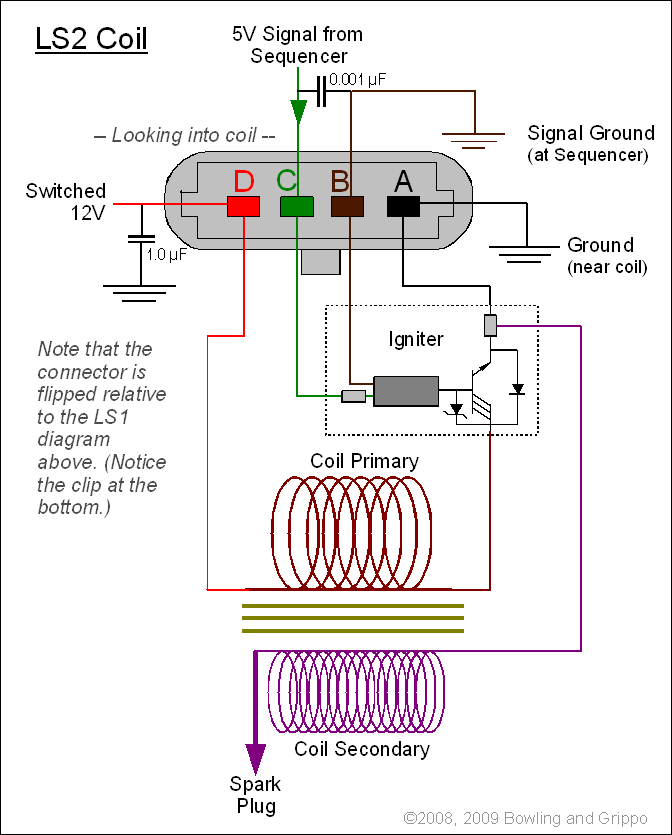

WIRING THE SYSTEM UP
here is the wiring diagram i pulled from megasquirt

ALL OF THIS INFORMATION WAS PULLED FROM THIS PAGE. UNDER THE LS2 SECTION
http://www.megamanual.com/seq/coils.htm

Here are the dwell settings for the LS2 coils, again from Motec Aus via IJ:
Batt V Dwell
8V 10.2ms
9v 9.2
10v 7.4
11v 5.5
12v 4.4
13v 3.8
14v 3.3
15V 2.9
If you search ebay for "D514A" you can pick the coils up individually for no more than $20 USD each.

northwestsupra
Sep 19, 2006
1,166
Washington, Marysville
theres a picture above that i placed on here, is that the connector for the ls2. the ls1 sounds like it was different it just has 4 pin holes, while ls2 has 4 used pin holes but 4 holes used to keep it straight.
