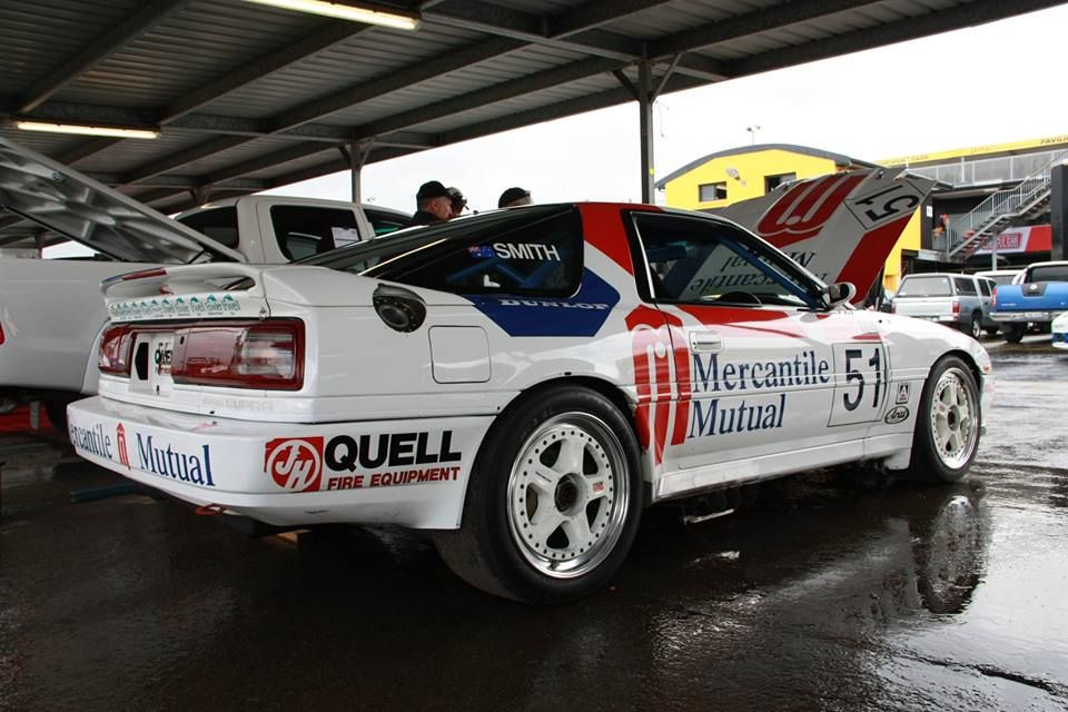

Gidday John,
I run a Z20 soarer soon to be A70 Supra 7m powered sports sedan. I am near Sydney.
My car has around 400rwkw, and its runs a Cusco 2 way diff 3.7 ratio. The diff is very tight
however it dosn't cause understeer. I would recommend Cusco LSD
to anyone for racing use. I ran at Wakefield Park raceway late last year and the car
had very good turn in.

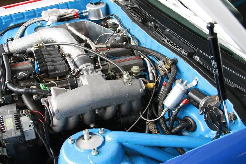

Needles to say OS Gilken R154 is nothing more than a Joke compared to what John has in his supra. His gearbox is HewLand (incorrectly reported by Terry as Holinger on turbosupras.com) , it has magnesium housing and dogBox internals that are good for 2000+ race miles. Original cost as over 35 000 GBP when new in 1988 which in today's money is more than $100 000!
Interesting fact ,that very few people know, is that when the original batch of 10 transmissions was gone ,Toyota factory racing team (TRD and TTT) went true the trouble of filing for VO with FIA homologation for a Getrag transmission that they used one of their last Enduro races on SPA in 1990. Interestingly enough Bemani (private EU team) ran Getrag(s) for many years prior in their 7M-GE powered cars. Even more interesting Toyota switch to Getrag could not change their destiny - the factory turbo cars were yet again SLOWER than the European private naturally aspirated MA70!

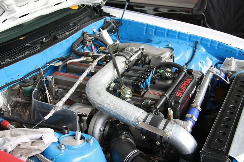

Hi guys , yeah I"m really gutted, my wife has even locked up all the sharp knives for the next couple of weeks. We had a test day early last week and all was going well , the car was very fast, in fact heaps faster than the race winners times. Then out of the blue it threw a con rod out the side of the block. there was no real warning . We wont know what failed until we pull the engine out and strip it down. However it looks as if it was a component failure . I am really disappointed for the guys in the team , they have busted there asses over the last 6 months only to have it come undone at the last hurdle .. Anyway we are regrouping and are very determined to get on top of this engine . I am very lucky to have such an enthusiastic bunch of people around me and we know that we have a very quick race car . All we need is some reliability,and I know that will come. Thanks for all of your support . WE WILL BE BACK Smithy

Some fine car control from John Smith on the corner exit Note how down to earth this car really is - so many OEM parts in the engine bay including the Factory Accordion hose and OEM BOV (these parts were not OEM in the MIL MA70 Supras BTCC or R.A.S. cars in ETCC ,wonder if this was CAMS and JAF regulation only).
The 'Des Wall's Chevy V8 supra' is another purposely build race car ,but under very different regulations (John's car was GroupA ,the V8 supra was Group 2D). As such I do not believe that it was related to the Supra Chassis at all ,it was raced in a very different body and then converted in 1989 to Supra Skin - you can see this on the wall just behind the car ,original owner was Bob Jane and it was Chevy Monza before it was rebodied as Toyota Supra in 1989.
In 1989 when the private teams realized that there is absolutely no way on earth that the Supra can ever be competitive in Group A some cars were converted to race in Thundersaloon races in UK ,IIRC they all ran V8 engines but used the original magnesium suspension developed for RAS ,MIL and Bemani by SPECFAB. Interestingly enough they all looked quite similar to the Des Wall Chevy Supra:
