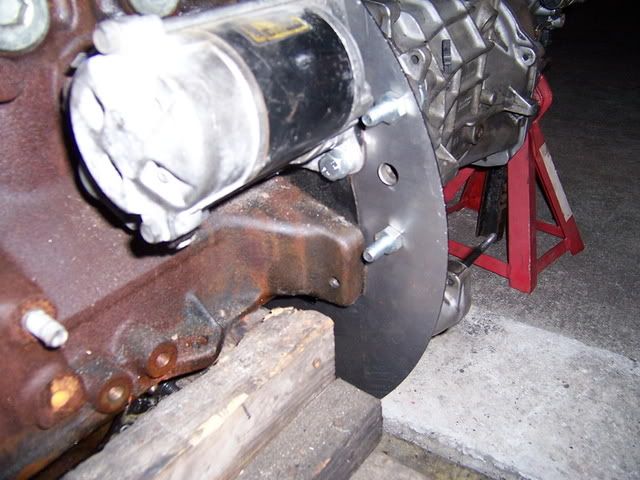

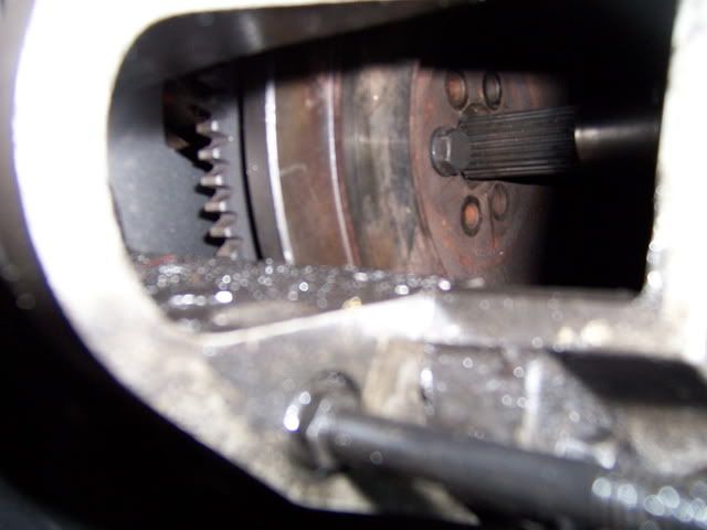

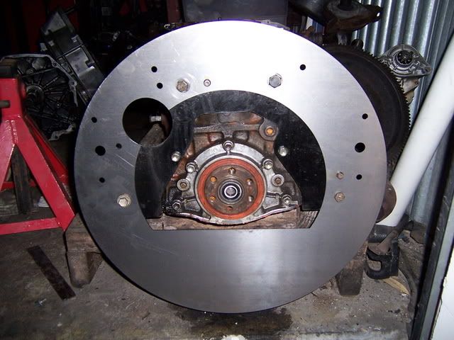

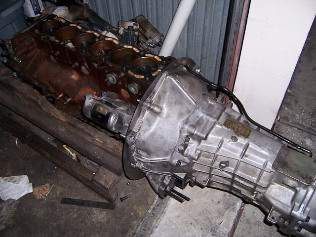

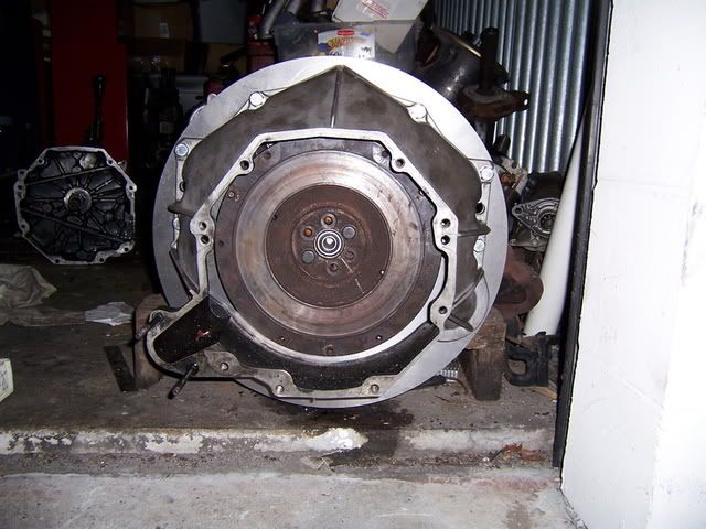

pretty damn good news. got the 2nd test piece today. it appears to be perfect. bolted right to the block, started bolted up. i hooked jumper cables to the starter and made sure it turned the engine over. jumped the damn thing all over the place from the tq but the gear in the starter is lined up perfect so thats a relief. then put the bh on, dowel holes seem right. though what im going to do, and i recomend everyone else that buys one do, is dont try to press dowels into the plate. im instead going t put them in and weld from the front side to hold them firmly in place once the bh is on so i know it will always line up correctly. then i put the transmission on. heres the thing i cant check yet as i was by myself. this test piece is 16 gauge, which is thin. so it was flexing under the weight of the trans. i had a jack under the back to level it out. some spots it was perfect and spun great, a lil either way it was hard to spin. so heres the deal, im going to have to wait till my brother comes by. gonna stand the engine on its nose so itll put the trans up in the air veritcal so i can line it up and be 100% sure the snout is lined up dead perfect into the pilot bearing and it spins free, im also wondering if maybe its just going to deep int othe pilot bearing so will space the plate back with 1 washer at all 4 holes to the block, just to be sure. then i will have the outer section trimmed to match the bh and mail it back. they said tey can modify the file to cut it out to match the outer diameter perfect. so im going to have them do that. my solidworks skills arnt good enough to do that myself yet.
anyway, its progress and almost ready to start the group buy. if its lined up perfect ill go ahead and get permision and start the group buy for them.

more good news. found out why it wasnt turning easy when lined up, as i thought of after i had already got home last time, the input shaft of the trans was just going too deep into the pilot bearing and actually touching the crank. theres a nice shiney circle in there where it was rubbing cause this new test piece is only 16 gauge. i found this after testing it up in the air and still hard to turn. anyway, spaced it out with 1 washer at each hole and stood it straight up in the air like i mentioned before and sure enough, it was working great. so its perfect. traced the outer part of the bh on the test piece and my bro is bringing his jigsaw and metal blades tomarwo so i can trim the outer part and mail it back to the cutter to have them mod the file for it so itll be cut perfect on he outside as well instead of a large 19in circle. anyway, ill take a pic tommarow after its trimed and start the group buy. its already been approved.
