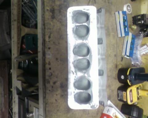

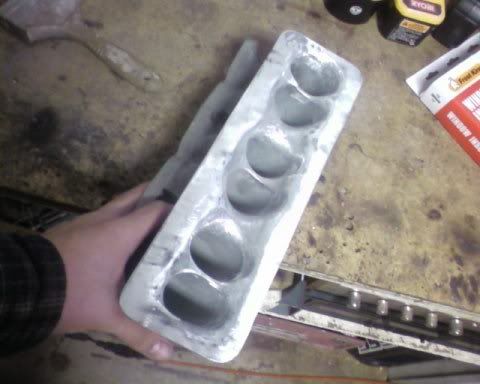

I am making one for my 5m right now and I just took a spare upper intake and chopped it off at the top of the runners, then made a base of the chamber for it, I have made and bent the actuall chamber out of 1/4 inch aluminum, just havent got it welded.
but here is the base and runners that I have done.
That portion bolts to the lower runners.
But the best way to do it is just to mock it up. The more you can mock up at a time the better, so you dont do one thing, then find out you cant use it later on cause it interferes with something else, etc.
