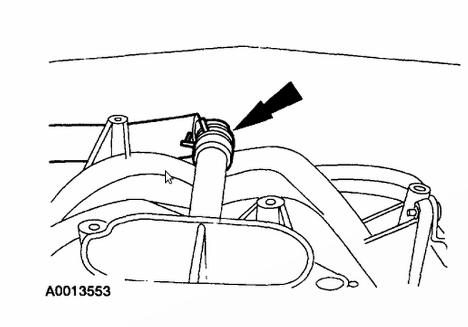

Supracentral;1657707 said:
Plugs are one candidate, there's a 90 deg rubber elbow at the back of the intake that has a habit of cracking that I've replaced - makes the truck run like complete shit if it's leaking.
Is this the elbow your talking about?
Supracentral
10,542
10
[thumb]http://i3.photobucket.com/albums/y81/dirgle/Fordintake.png[/thumb]
Yea, that's it. It's is called the PCV End Assembly.
The Dorman HELP! brand has the part. I got mine for under $2.
The Dorman part number is 46017.
Dirgle
Conjurer of Boost
1,632
Pauma Valley, CA
Hmm after doing a little research I think you may have solved an intermittent problem I've been dealing with. It's hasn't done it recently, but on occasion the engine would randomly rev up to 1600~2000 rpm if I was sitting at idle. I would get some weird looks from people at stop lights. It would only do it for a few second and then return to normal. But it hasn't done it recently so I wasn't sure where to start looking. The local Oriley's auto parts has one in stock, so I'll give it a look tomorrow.
