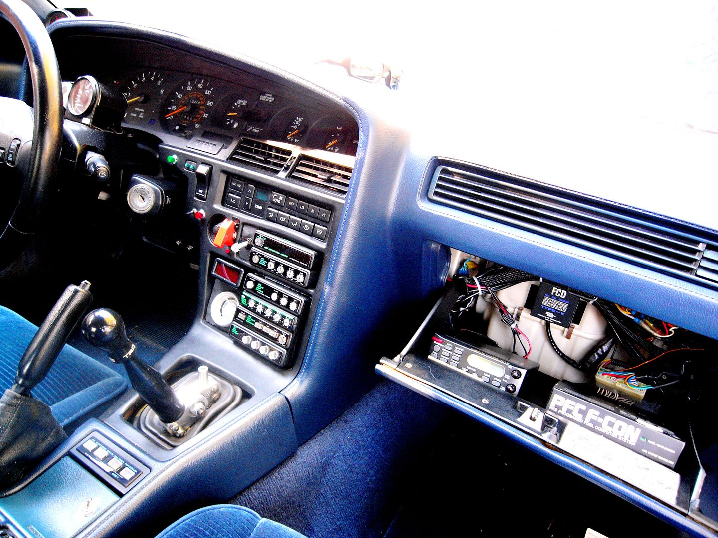

Crisp, you are officially the "Gizmo-gadget-SUPER-FREAK"!! Look at all the stuff in your car! Does your car require a 1.21 Jig-A-Watt Alternator!?
Sorry. I know I didn't add or enhance your information; but, this is a great write-up!
Good work and keep feeding that Flux Capacitor! ;)

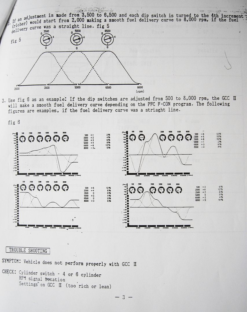

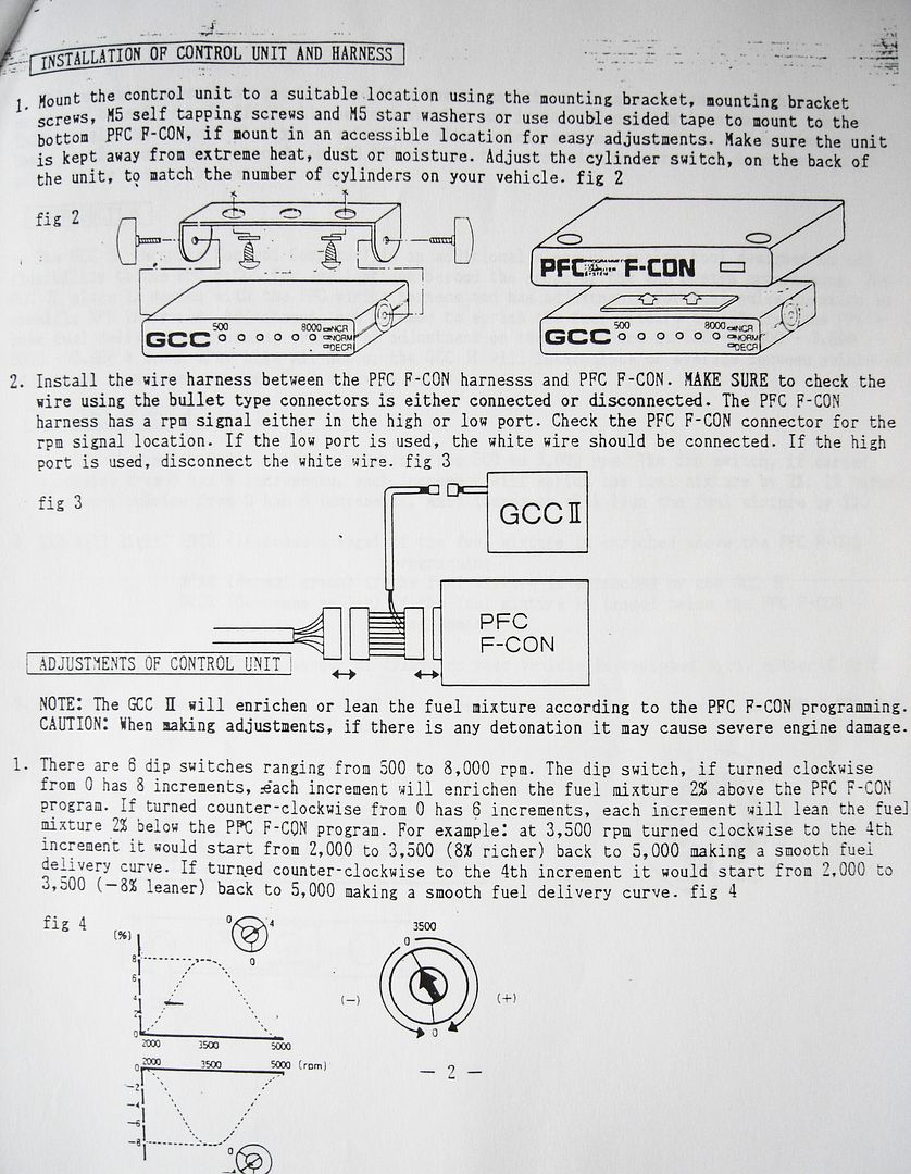

...speaking of gizmos... I made some adjustments to the other alphabet soup letters while I was fooling around...
Switched the GCC's graphic adjustment points to boost from rpm recently, and just shifted the scale from 0.4hg 0.0hg 0.4 0.8 1.2 to 0.6 0.0 0.5 1.0 1.2 1.5 Although I don't boost that high, the slight shift in the lower and mid ranges made a nice affect on my tuning points.:)

No problem! Biggest difference I encountered is that the fuel curve is MUCH more contingent upon BOOST + RPM with heavy bias on BOOST LEVEL at any given RPM then simply RPM alone. When you are trimming the fuel level as an RPM specific variable, you are assuming the boost level to be essentially "constant" otherwise, whereas in fact, the BOOST level is what dictates the greatest variance in fuel trim NEED over the RPM. Essentially, boost doesn't "HIT" until around 3k~5k depending on your turbo size, etc... so the SLOPE for the fuel delivery gain through that RPM is a huge transition point that is hard to tune, PLUS you have the onset of boost pressure rise off a fuel pressure regulator to deal with. By trimming for BOOST pressure, you are better able to prioritize your fuel need at any given RPM as a byproduct of the spool-up, which has the finer resolution across the entire RPM range and seems to net the better tuneability from my experience.
Also, by using BOOST for the fuel trim driving force, it lets you better control VACUUM state fuel, i.e.: TRIM BACK fuel at 0.6 vac on snap off throttle and CURB the fuel that RPM would otherwise "dump" causing idle/stall more easily. Helped me to MOSTLY solve my off-throttle slow-down to a stop tendency for the car to want to DIE. Now it trims the fuel on hard vac more aggressively and settles into idle without loading up like it did before. (I know, I know... a stand alone would do ALL of that and TONS more! Just try to RIDE and TUNE with a laptop though...:biglaugh: MUCH easier with a little dial at your fingertips wherein you can gently "click/click/click" up and back a notch or so as you actually load the car in differing gears and boost levels while you drive. FUN!;)

I spy a BCT7 in the glove box! I have one in my daily driver - comes in handy when the highway patrol are using their plane to pace vehicles for speeding :3d_frown:. My V1 handles everything else when they try to fry us with microwaves or laser beams.
crisp
existentialincrementalist
May 25, 2007
1,785
Ohio
GOOD EYE! I love my BCT7! (Sorry, I missed this post!) I also use the V1 with mine.:biglaugh:
