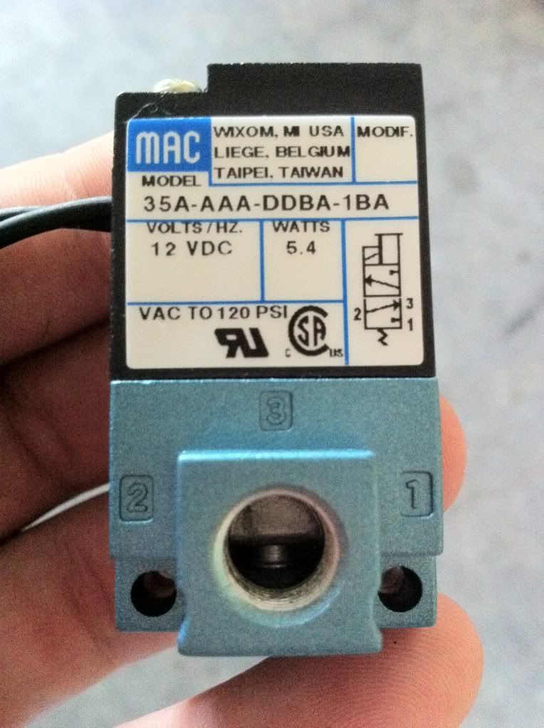

Got a boost solenoid

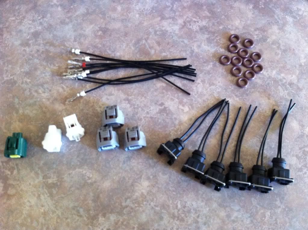

Got Viton Seals and injector clips
AN fitting for fuel rail

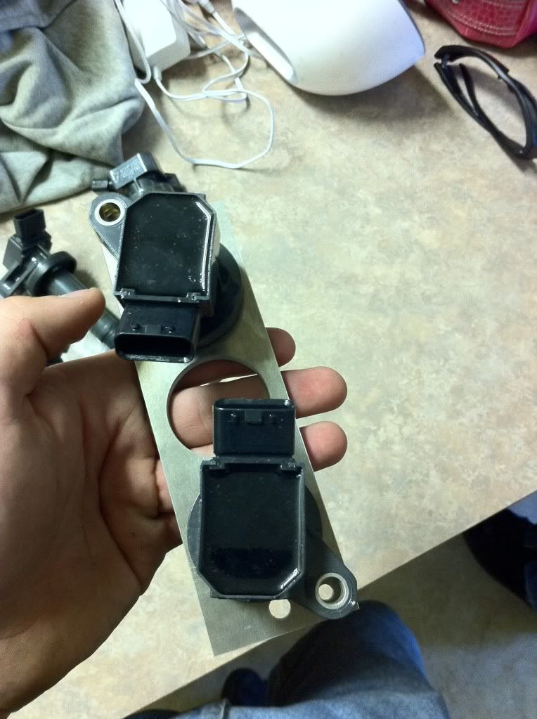

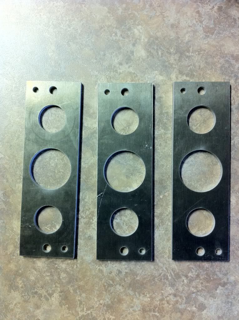

Custom made 1ZZ brackets

wow! progress looks good so far, whats the advantage of using the 1zz coils over the 2jz coils? is proefi a standalone? btw i need some new plugs like injectors, coils, knock sensor etc too, how much did the new plugs cost you from driftmotion?

1ZZ coils have built in ignitors like the LS1 coils. Cleans up a lot of wires. People run them on the stinger or AEM on a batch fire. ProEfi will do sequential. so making 700 will be too easy. Yes ProEfi is a standalone. One of the best IMO. The user software is awesome and all the fail safes you can control are endless!

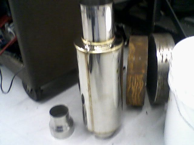

Just recieved 4'' muffler, 4'' tubing, 4'' to 3'' reducer, 4'' v-band kit. I-boost switch. Back pressure Kit. 272 cams will be here tomorrow =]

Interested to see the muffler, were'd you order from? and what type?
Got it from Ebay :naughty:
Its a 4'' inlet. 4'' outlet. 6.5'' Dia. Its SS made by Vibrant. Its just your generic Fart can. =]
---------- Post added at 07:17 AM ---------- Previous post was at 07:13 AM ----------

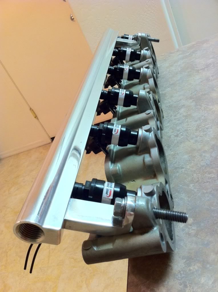

Heres A shity photo:
