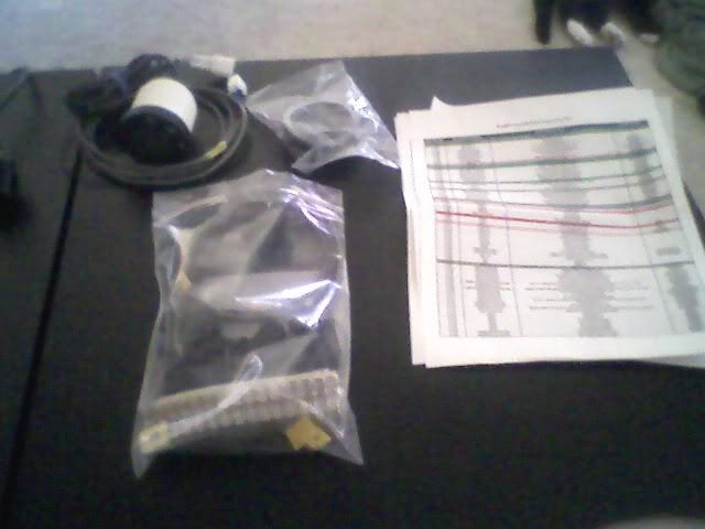

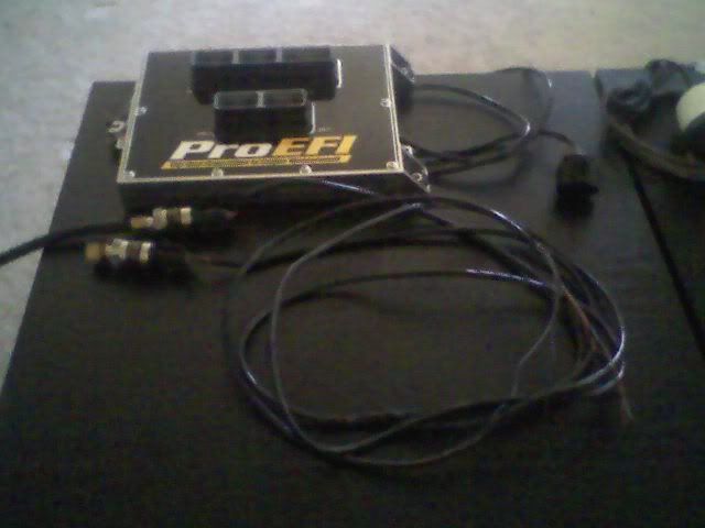

Picking up the Proefi =D

IBoughtASupra;1675467 said:
Where did you get the ProEFI? I am looking to get the 48 EMS.
This is my friend that picked it up used locally, Try to get the quote from SP and then we can probably get a quote from ProEfi here in town and see if there is a difference.

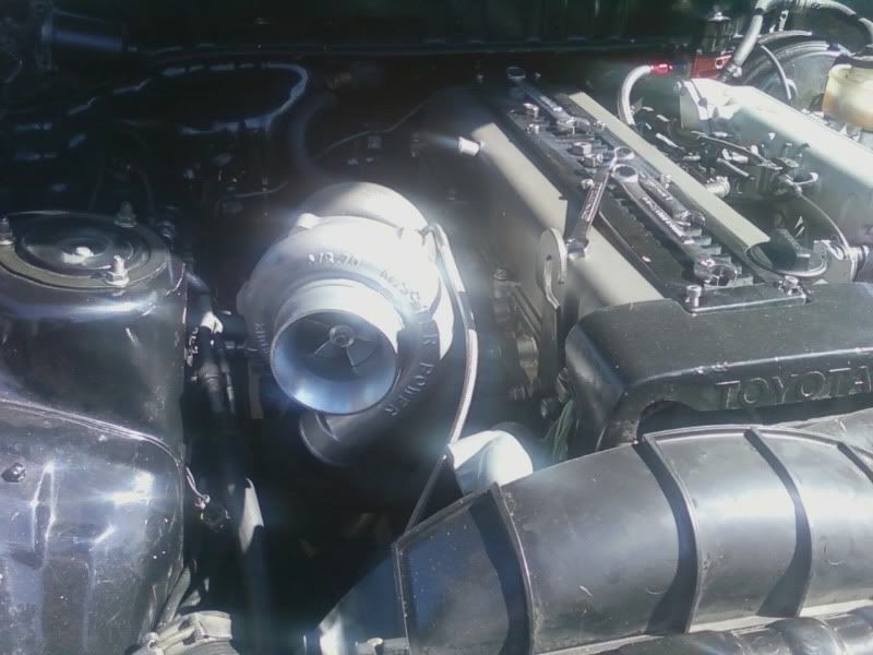

Heres his new MP-T70 turbo installed

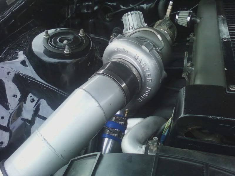

northwestsupra;1675720 said:
i have a mp-t70 its a sick looking little turbo is you ask me, price aint bad either. Cant wait to see what it does on the JZ

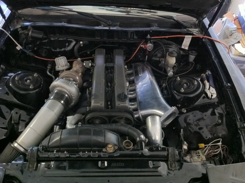

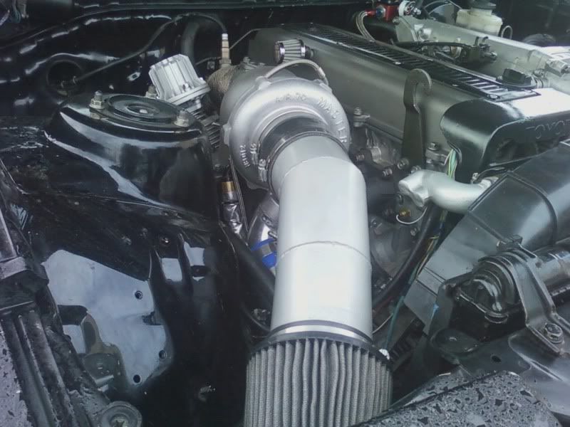

I got it running a week ago on stock ECU. It spools very similar to my old Garrett 67mm. the MP-70 Has The S cover .70ar, which seems to get into boost more consistently. The .50ar cover on the 67mm would take forever spooling 1-6psi (5th gear) but from like 8-17psi it had no problems. May have been a tune issue tho. idk, or maybe its just been forever since ive driven it.

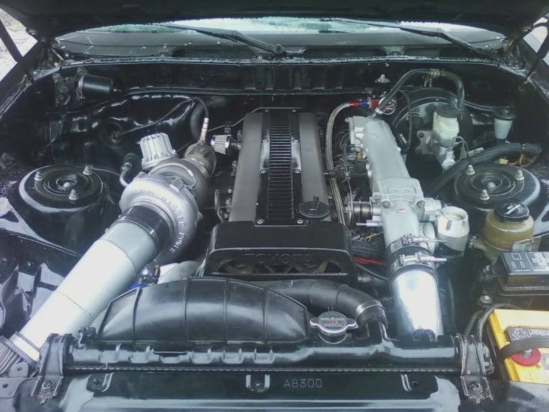

Here is the engine bay completed:

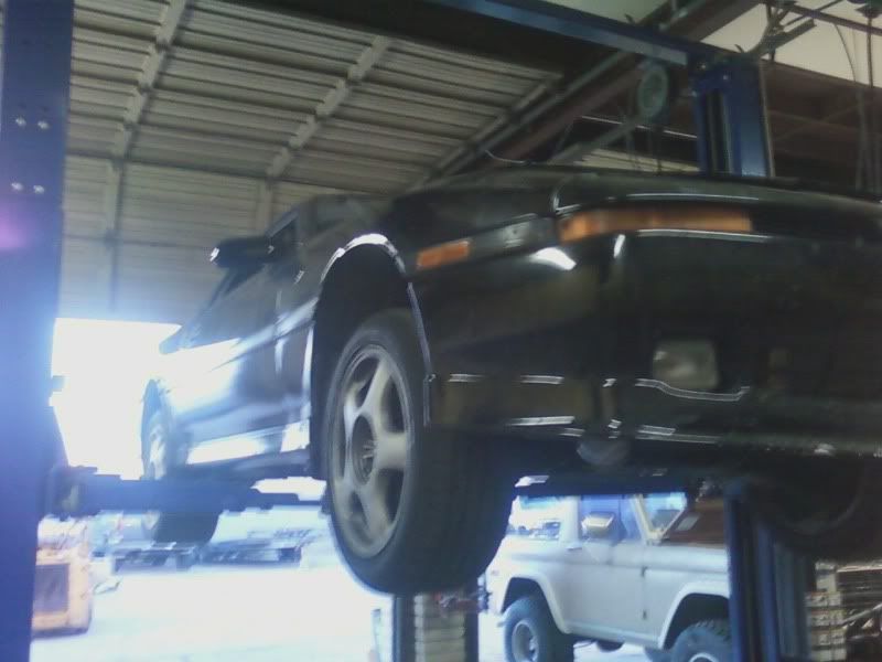

Here she is up on the lift. Getting Poly Tranny mount, and a fresh thing of Redlind MT-90 Gearoil.

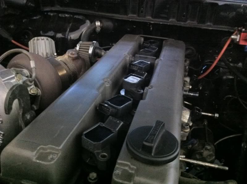

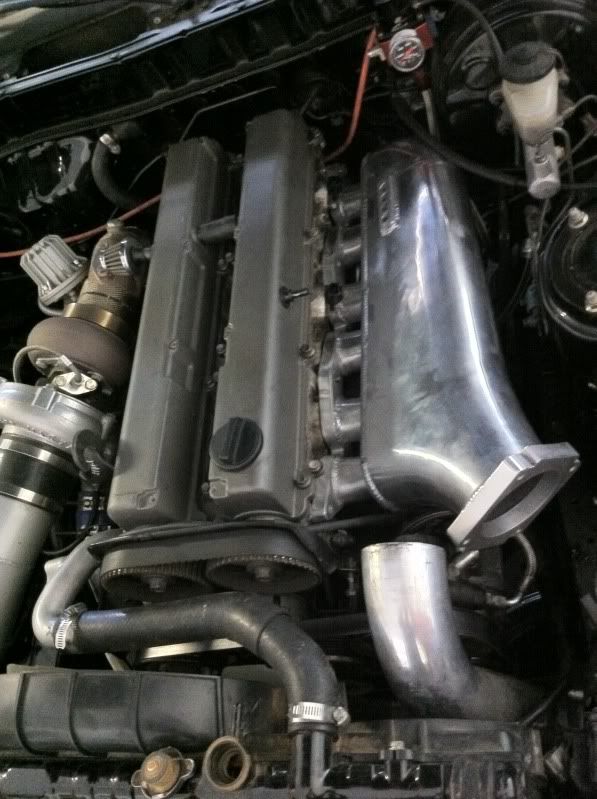

update:

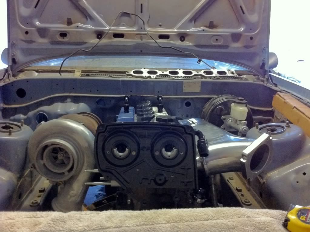

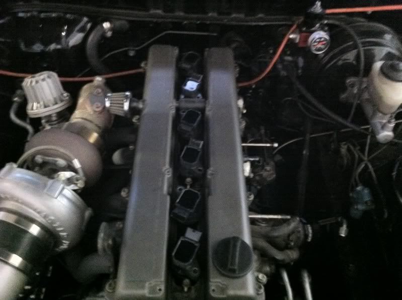

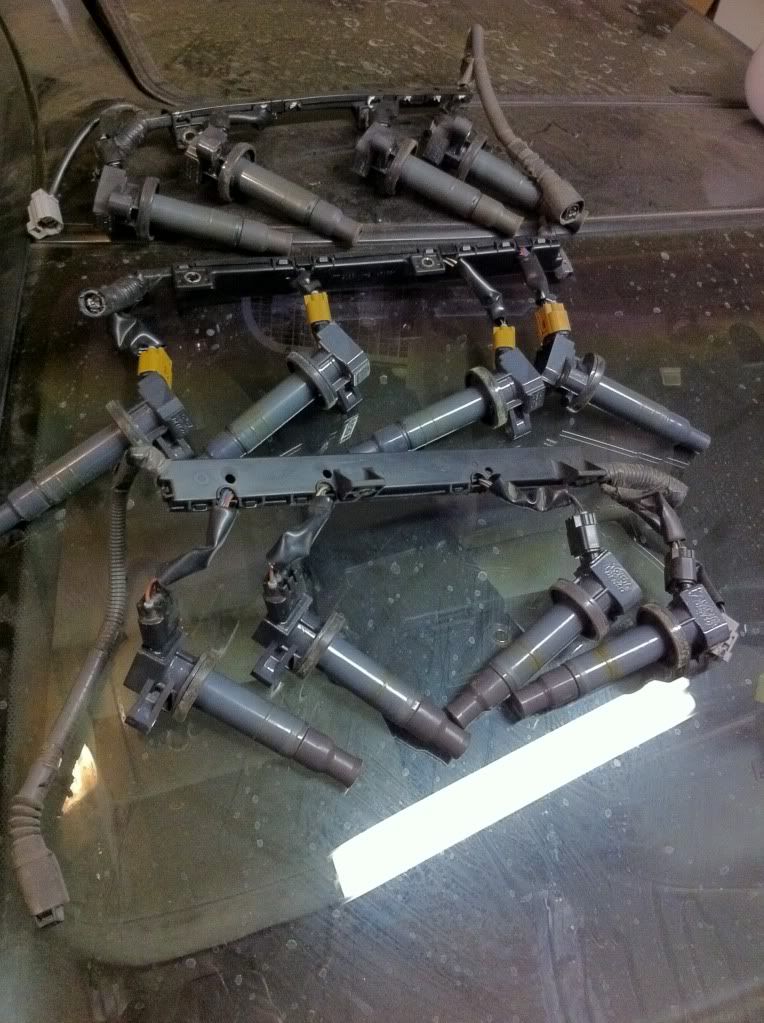

1ZZ coils mock up

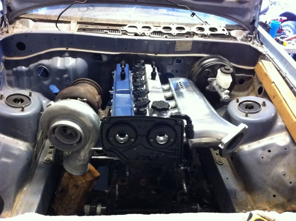

FFIM mock up
Found Out Heavy moddification would be needed to run Driftmotions FFIM in a MA70-1 chassis. Oh well, thank god its going on a 7M

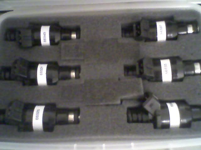

Just recieved my 1200cc Precision Injectors:

kamikazemkiii;1700928 said:
What intake manifold is that? Looks like its coming along nice!
---------- Post added at 02:02 PM ---------- Previous post was at 02:00 PM ----------
Nevermind.. Just saw it, What all did you do to the manifold? Very curious on input I plan on using this manifold Pm me if need be.
Thanks
Okay, well its a DM manifold. It was purchased by my roommate who plans on putting it on his 7M.
The problem with this manifold is that it does not have the ports for the injectors. and not enough room in the engine bay to bolt this manifold to the stock runner. So it would be easy, just cut half the lower runner, cut the FFIM flange with the half the tubes, then reweld, wont look as pretty but you will be able to run injectors, and it would bring it in a little tighter from the brake booster. you would obviously half to run different hardware to bolt it on, for the stock studs and bolts are too long.
I personally dont like the look and I plan on only making 700rwhp. So I will be leaving the stock manifold on.
