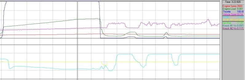

Little update:
I am running 2JZ-GTE coils, but in waste spark and actually having trouble because I don't think the 2JZ-GTE box is strong enough to power 2 coils at the same time in waste spark mode.
Car will rev to redline with no miss but once the boost goes about 9PSI it misses. I have several which are cracked which is a known issue with the GTE coils. SO new coils are coming today to see if I can't get it to make some real boost!
Real weird because no sputter at <28% throttle but at wide open it has a terrible sputter. So I am thinking the coils are to blame(also 5 have cracked ears, known issue)
anyways here is a picture of a log:
9PSI at 2660rpm!!!!!! This was just 5th gear 2000rpm and flooring it(no boost controller turned on which means it will spool even faster with the boost controller on due to on WG spring alone it creeps open well before 9PSI instead of popping open when the BC is turned on!!!)
Still trying to figure the best way to run the boost controllers without overlapping each other and controlling the others WG based off the manifold pressure.
Thanks,
Seth

sethron71;1720994 said:
Little update:
Thanks,
Seth
What plugs and gap are you running? The higher the cylinder pressure, the harder it is to light off that spark. I recommend copper plugs and running your gap down to .018 to .020.

How do you have the 2JZ-GTE coils mounted, did you just push each one on each plug or are you using a bracket setup similar to the 1JZ/2JZ setup for each pair of coils?
