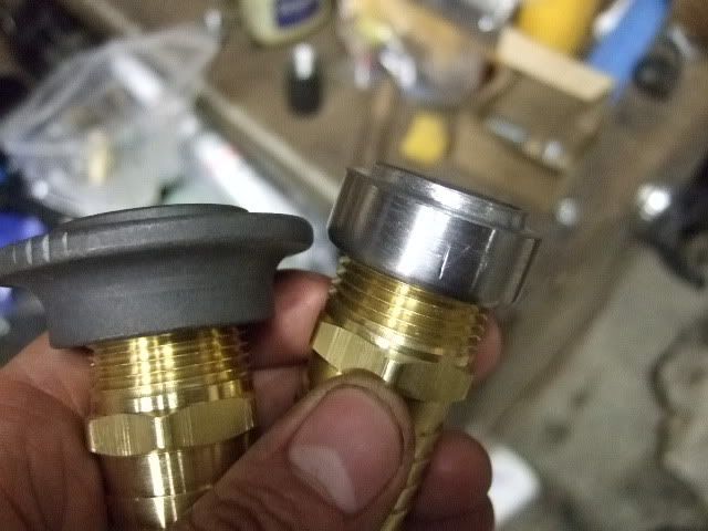

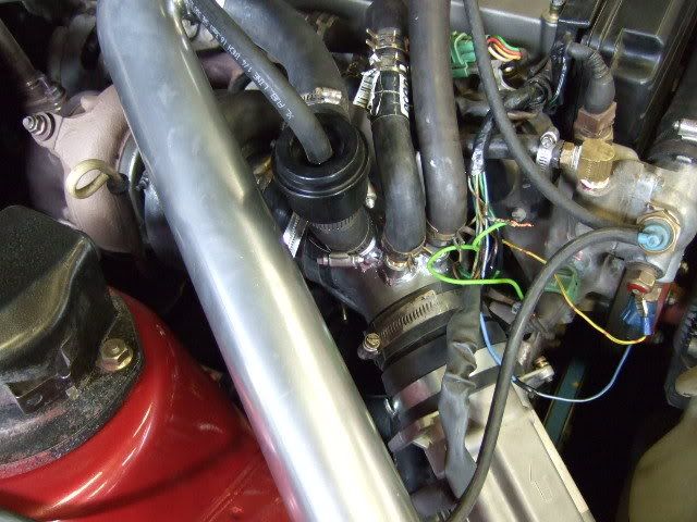

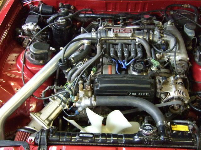

First item on the agenda was too add all the needed ports the the intake pipe
Heres the flanges I had, I put them on the lathe and took off all the excess uneeded meat. The original is on the left, the turned on the right if you couldnt tell.

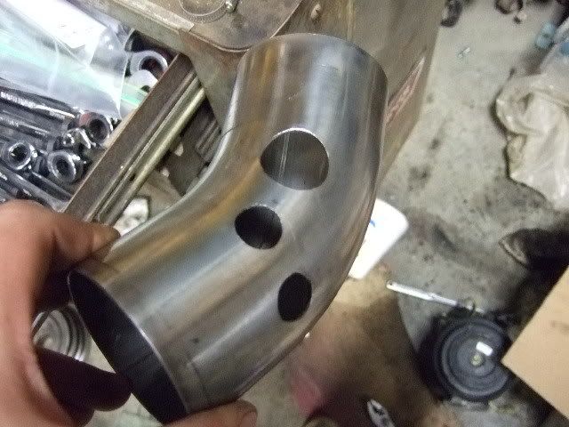

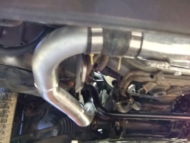

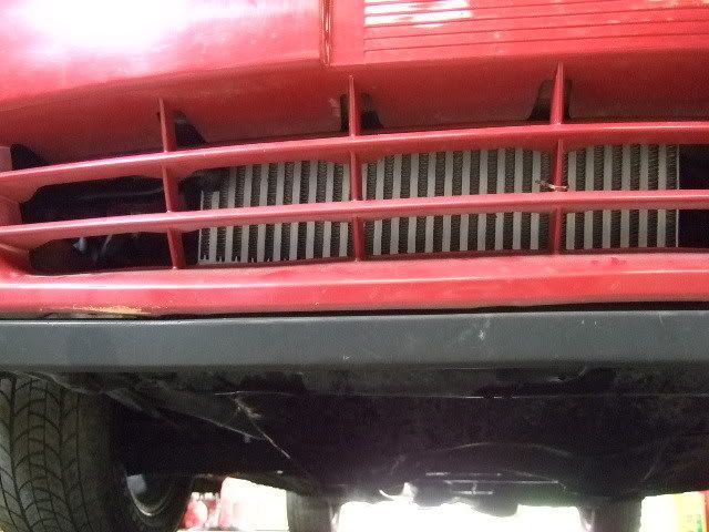

Heres how the lower IC pipe came out when fitted.
I had hoped to get most of the work done friday night. My plan was to prime and start it that night so fiday morning the front end was the only thing left to do saturday morning when I got home from work. Not the way things went to say the least. I got the IC pipes and intake done with all the ports and and the lower IC pipe on but didnt have time to paint them. Called it a day around one, got up for work at 4am. Saturday I had to pick up some hose and a few fittings on the was home and pick up my grandpas thunderbird so my brother could drive it too prom. So I didnt get home untill almost one with a lot of things to do yet. I added one more port to the bottom of the intake for the ps vent and painted them.

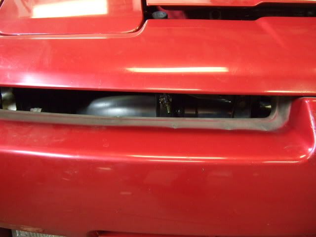

Put the front bumper on and the upper IC pipes and intake once it was dry.
Pulled the EFI fuse to prime it, turned the key and all my starter did was click like it didnt have enough juice to extend the bendix all the way. At this point I was praying my battery was dead. I have had nothing but problems with the fidanza flywheel and wondering if it could have and issue with the starter as I never tested them. Finally I put the EFI fuse in and pulled the coil pack plug and it cranked righ over??? Primed it untill my oil pressur topped out, checked and added oil, plugged the coil in and it started when I tapped the key. At this point it was 1 in the morning again and I couldnt resist taking it for a drive. Depite the temp guage not registering, tail lights, battery and engine light being on and flying into fuel cut everything worked. The engine and battery lights were due to a shot battery, the check lamps light because I didnt reinstall my front turns yet and the temp gauge wire had broken off right by the sensor.

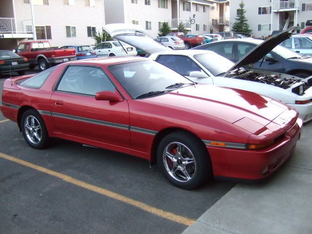

Heres her almost back together the next morning after the first drive.

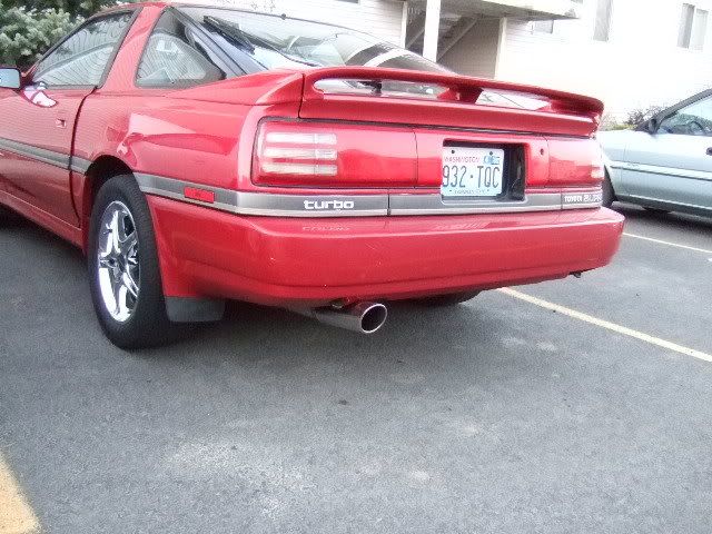

I took it for a longer drive and no more issues. The exhaust was louder than I wanted and dronned really bad an almost any speed. At this point I had the partial dragger on so it was duping right under the back seat which I hoped was why it was so loud. I added a bolt on rear section to bring it out the back and it went away. Before it was louder inside the car than outside.
The car made the 83 mile trip down to pullman. I was aprehensive to take it on a trip that far right away when I had only test drove it a total of 20 miles. The alternative was to leave it home this week and then come home on friday and leave at 5 on saturday to make the 300 mile trip to centrailia.

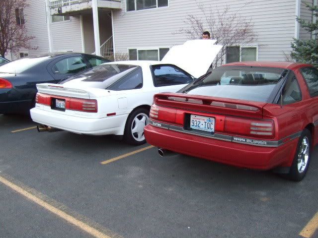

Luis came over to see it and go for a drive. The first time I took it for a drive the waste gate line was barely on so that is why I hit fuel cut so ealily. With it on all the way its boosting about 6psi. Luise gave me his old Dr. Jones boost controller to remedy this.
The only issues now are a abs code 51 to figure out and my bosch bov has a leak and isnt opening all the way. So if anyone has one they want to sell, I dont care if its a 102, 103, 108,114 or 110 at the moment I just need one.

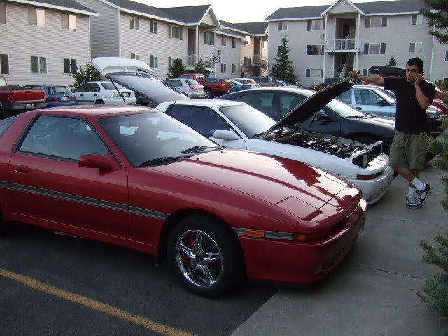

Who's that loser on the phone? Tell him to stop standing like a teapot.
About time you updated this thread i've been wondering if you were ever going to upload pics. I'll hit you up before you take off for home again, we need to do some side by side runs to test out any kinks before the long drive to centralia if you know what i mean :evil2:

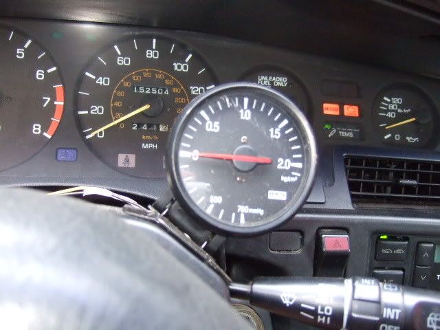

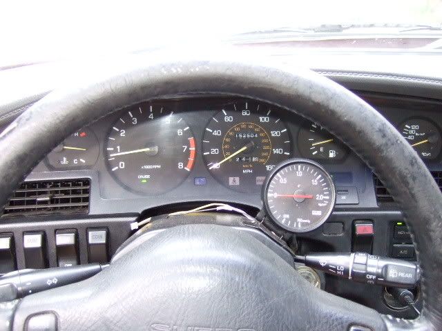

Its on but Im afraid to turn it up too much with the condition of my bosch. I also installed my hks boost gauge and its amaizing how inaccurate the stock one is. Deffinatly get ahold of me before friday at 1 and we will go for a cruiz

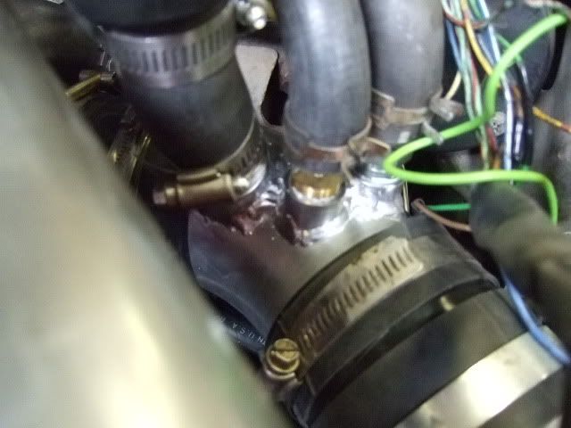

I realized I havent done an update since centrailia. First off the car made the 600+ mile round trip with almost no issues. I found a coolant leak when we stoped in tacoma, but it was just a loose clamp on a heater hose. Thanks again grim for the BOV, it sounds so much better than mine and I dont cringe before boosting anymore. I did find out when I got back that I had driven the entire trip with two boost leaks. I was happy with the power and the way the car was running before discovering them so I really cant complain. one was a port I forgot to plug on the HKS crossover pipe and the other was a 1/2 in split in the couppler between it and the tb. I also installed my boost guage finally and a Dr. j mbc.
The next thing on the list is new tires! These 225s arent cutting it. If anyone know where to get replacement bulbs for an hks gauge please let me know I havent had any luck finding any

I also have an HKS boost gauge (I believe you made fun of it ;)) but I never came with a bulb or connector so it's just not lit up. If you figure that would out let me know, I don't NEED to know what I'm boosting at night but it would be nice sometimes.

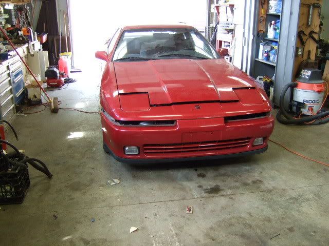

So I figured Id throw and update up here. I had a few BIG boost leaks I cleared up, and now Im down to the code 71 which just means my non CA egr has no temp sensor for the ecu to monitor and I dont think its hurting anything. The lift is finally in our shop! :drink1: I Also finally got around to cleaning up my back brakes. And best of all NEW RUBBER. Finally I will be able to go WOT in 1st & 2nd with out floating the back end! On a sad note one of the substrates in my RT Cat came loose and started rattling around. Anyone have any idea what they use to glue it to the shell of the cat???

Next meet is at your place. I'll bring a new torque converter so i can thoroughly test out that lift. As for the resonator, a simple fix would be straight pipe....? I like the new work environment should be much safer in a way with more space.
