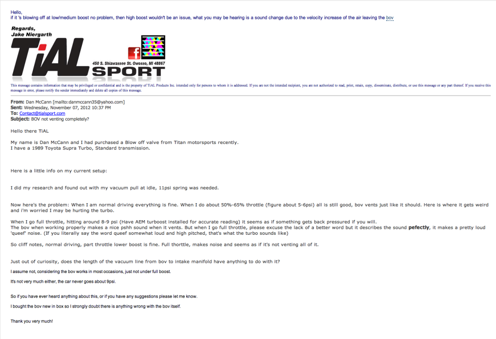

So this was the response I got from TiAL:
Wasn't too happy with the response to be honest..
I'm going to email him back and see what they say.
I changed my vac. line btw to a fuel line ( nice and hard) and it is still doing what it did previously.

I'm just throwing this out there but maybe he is right..I have the same bov as one of my buddies and they sound the same at low boost but I only boosted to 9psi and he has a fully built DSM boosting 25psi and his sounds extremely different when you get up there in boost...kinda like if your vacuuming out your car and ur shirt gets stuck in the hose..or your queef reference lol. And he has ran KT like that for a year and a half with no problems, sounds kinda cool to me?
