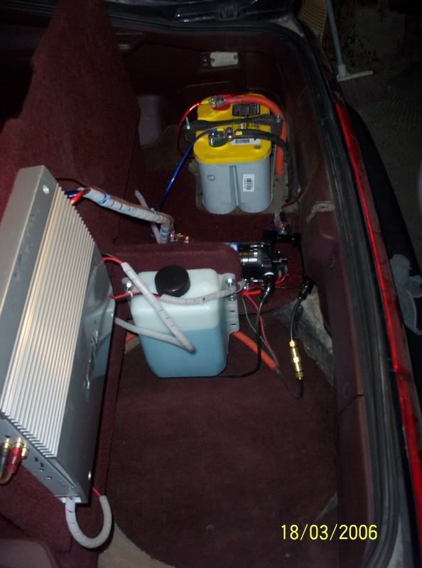

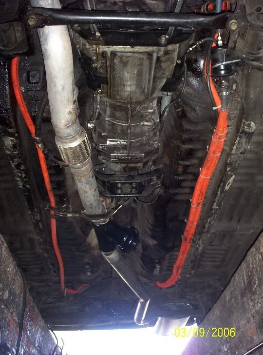

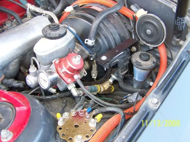

Here is my Set Up
I buy a Kit in Summit Racing
I wire positive wire with a electrical flex hose, front the battery to the engine.
For negative wire I connect the 3fit wire in the backside, and buy anther black wire to install from the battery to the engine bay
For the negative, I buy a ground kit

Is it just me, or is that exhaust cutout pointing right at your battery cables?
That is an old picture, when the installation was finish, I install a metal Shield plate to avoid the hot exhaust gas damage all the hose or wiring.
let me see if I have other picture with the metal shield install it.

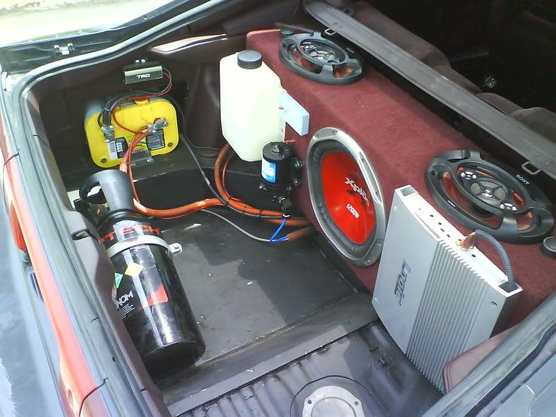

Heres mine w/ killswitch:
Still need to figure out how to cover the terminals on the switch though...

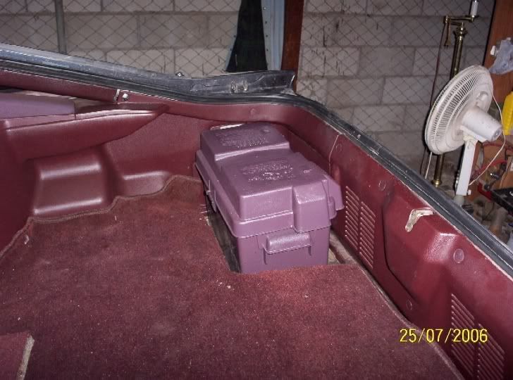

By track legal I mean drag racing and such. I occassionally like to drag race my Supra at PIR and I have to conform to NHRA safety rules. So my setup requires a metal box and a kill switch (still need to run a cable to the alternator).

Honestabe: I didnt think it had to be metal to be legal. The one I bought was NHRA legal if mounted behind the firewall in passenger area.

Captain, the battery box according to the NHRA can only be Steel or Aluminum. If you want I can grab the rule book and quote it for you. BTW, I have one of those plastic battery boxes but had to buy a netal box to be track legal.
