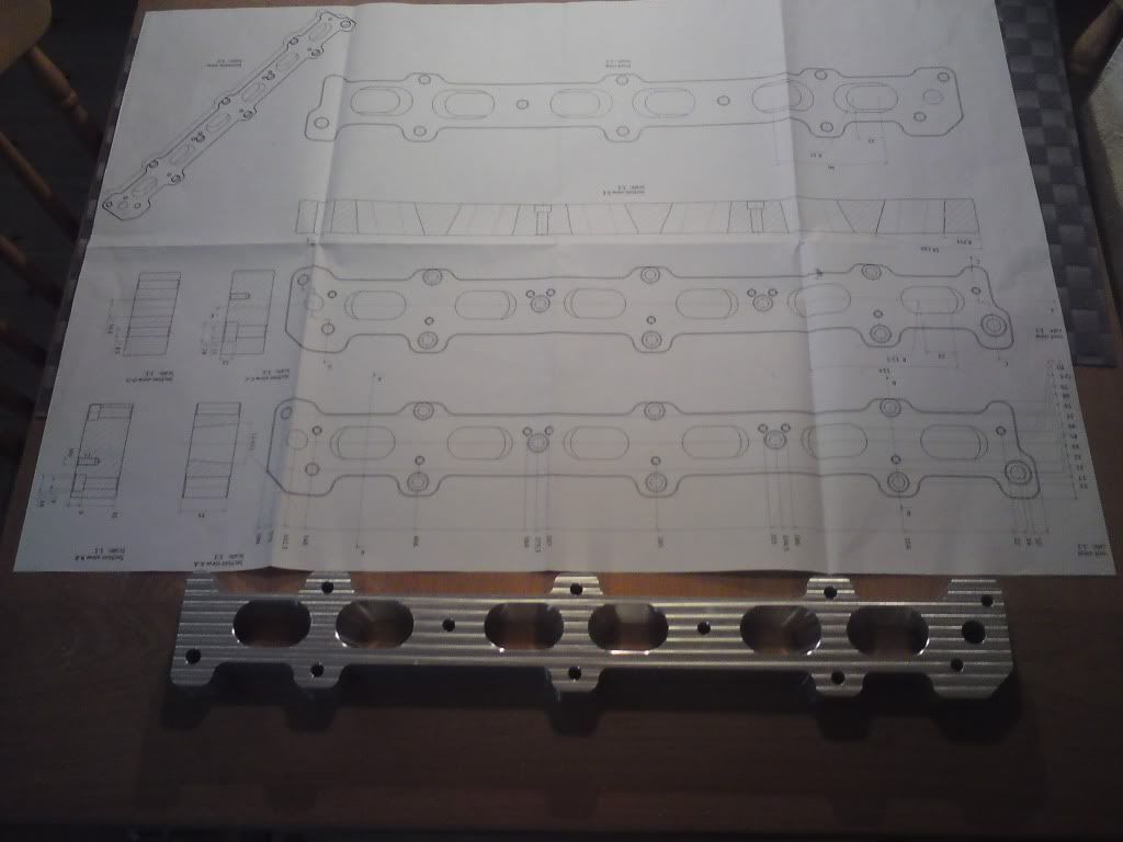

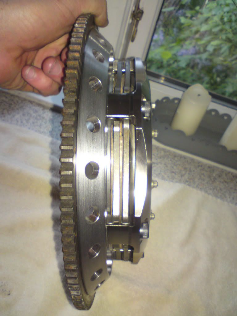

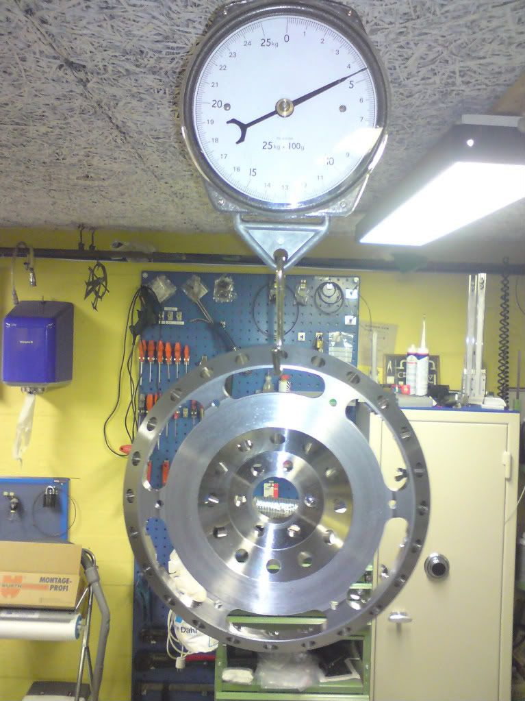

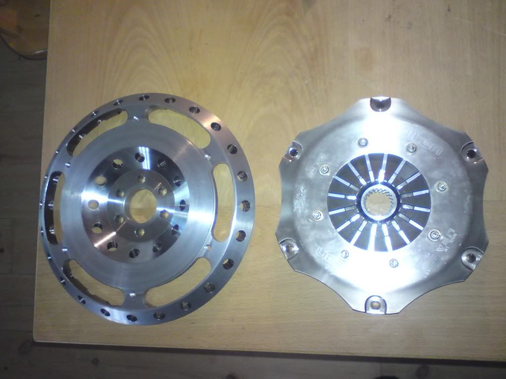

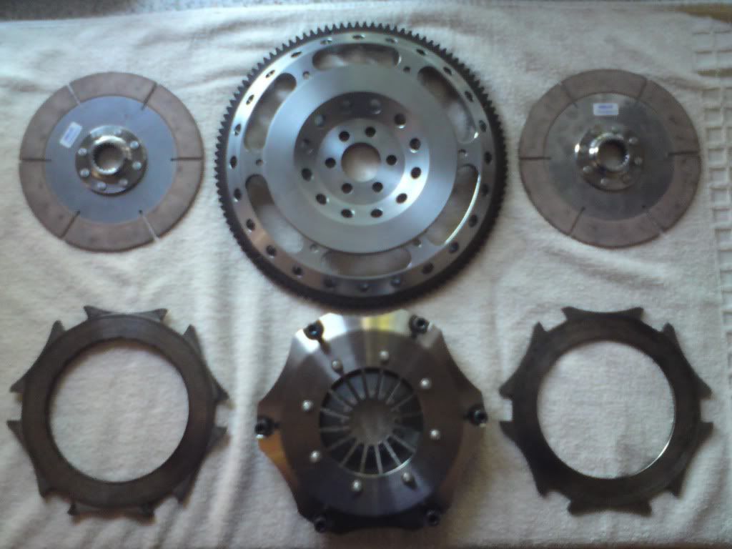

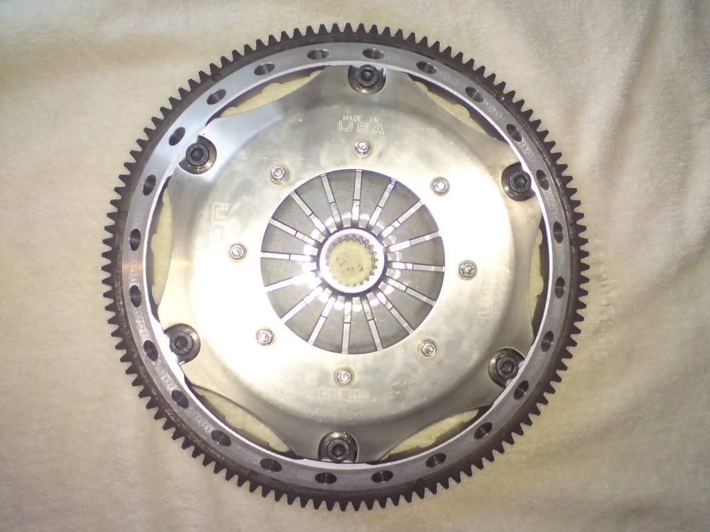

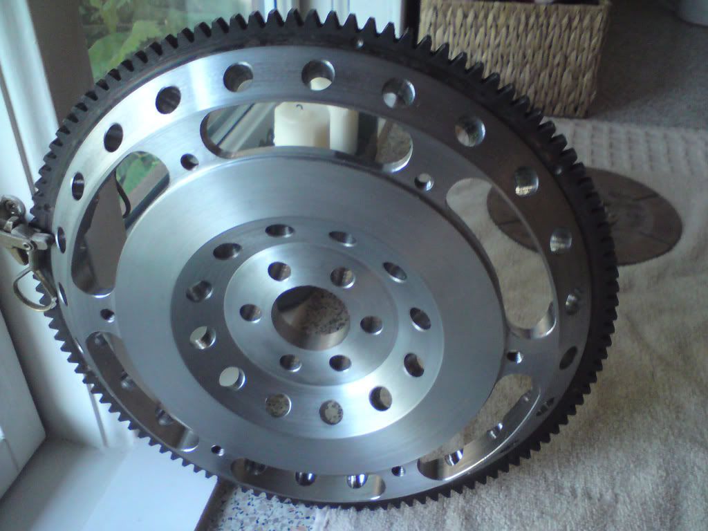

The flywheel will be this one that i also made by my self :).
It is tested on my other engine and works very good !
Incl clutch the weight is 8.6 kg, and the original is 17kg :).

i always wanted to know if you could make a 32. bmw itb work... did you make your own flange?
what about sensors?
you gonna run on mge electronics?
pretty awesome man

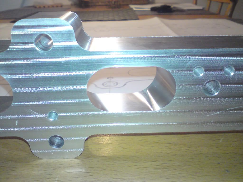

what about sensors?
pretty awesome man
Yes i first made a drawing of the flange, and then had it made on a cnc machine.
The sensors is all from the Electromotive Tec3R, that i use.
It is very good :).
