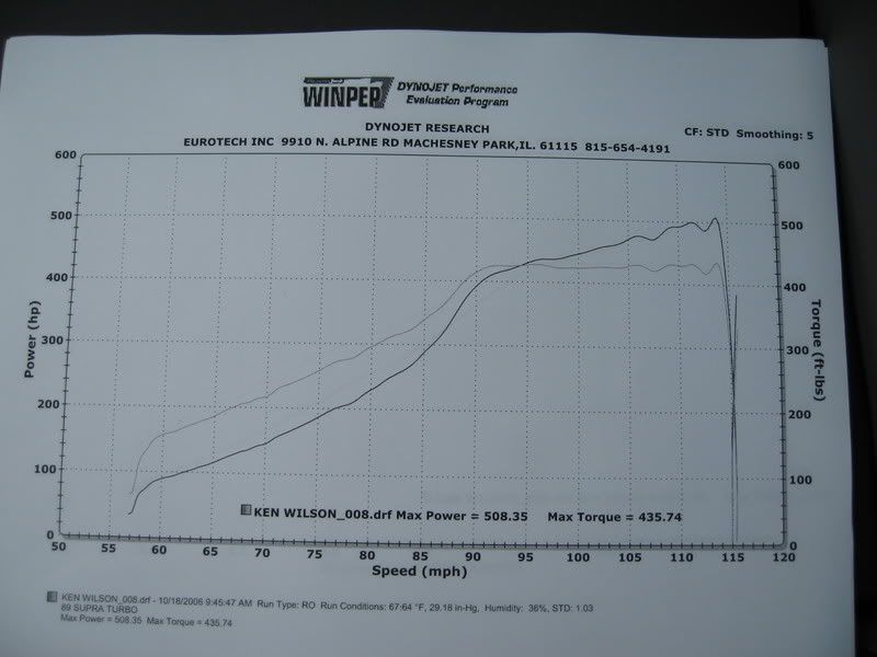

Finally got on a dyno for the first time ever, it was pretty cool, I got a video on my digi-cam, I will try to upload on photobucket and put it on my build thread tonight! Thanks to Drjonez and turbo bob for continuing support with the pro, I ran 23 psi with no fuel cut. They had a hard time with it being auto to load it up and get boost, so the lower rpm readings are lower HP than actual, he had to feather it up to speed to prevent kickdown. We had 4-5 runs in trying , so it was pretty hot, I didnt wanna wait around and cool it to get a few extra HP. VERY HAPPY! Also thanks to all the other members with sharing info on getting the pro to potential, I've been comparing notes with Mike Malloy, and we got this thing kicking some ass.

Awesome to see an auto put down some power. Congrats! Is it an upgraded tranny? I also seem to remember some method to keep the car from downshifting. I cant recall though.

congrats!
do you have a high stall converter or stock?
did you compare rpm vs speed vs power?
also, when dynoing an auto, it works best if you unplug the ect ecu (pass side kick panel). this puts it in diag mode and you can lock it in gear and not have to worry about upshifting and downshifting.
what you do is put it in L which is 1st. you get the car rolling up to speed. then you shift into 2 which is 3rd gear. from there you can start the dyno run at any speed/rpm without it shifting. do not shift it to D b/c this is OD in diag mode.
just thought this might be helpful to you on future dyno runs or anyone else that doesnt know about this.

Thanks guys! The trans is built, I did it myself with goodies from IPT, I had the converter loosened up by Midwest converters, and IPT upgraded the valve body. I have an ect analyzer at work, you unplug the trans harness, and connect to this, you can keep it in any gear you want and control lockup, I just didnt realize it would be an issue since I'm a dyno newbie. Next time I will bring it with me. I did get it graphed vs. rpms also db, it was 496 HP@6k, power drops off a little about 6100 rpm. I'll post that one on my build thread to after I get home from work tonight.
