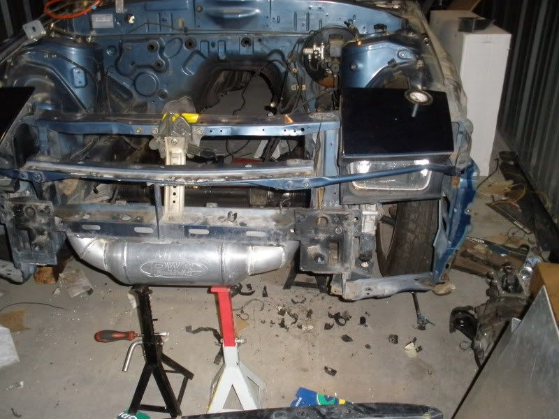

^ thanks for info..i have the second largest cooler pwr offers 650hp rated cooler the next one they offer is the 1250 hp and above rated. it will fit the car fine.
its a bad picture but its a general idea, Ive removed the cross piece of metal and installed 1" square tubing for the support so it fits up there nicely
