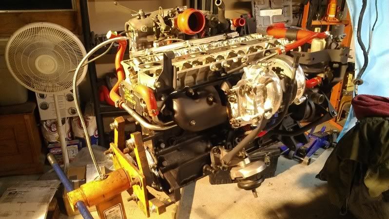

Fast forward to Fall 2011. I finally made friends with someone who actually knew what they was doing. We naturally started talking about the Supra, and eventually formed a plan to rebuild the motor.
I've learned a lot in the past year (including watching/helping said friend rebuild his f20c, among other things) and now my build is nearing its final stages.

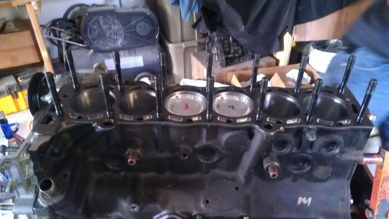

-Built bottom end

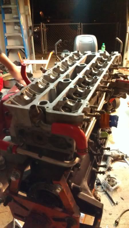

-Motor shaved and decked for an MLS HG

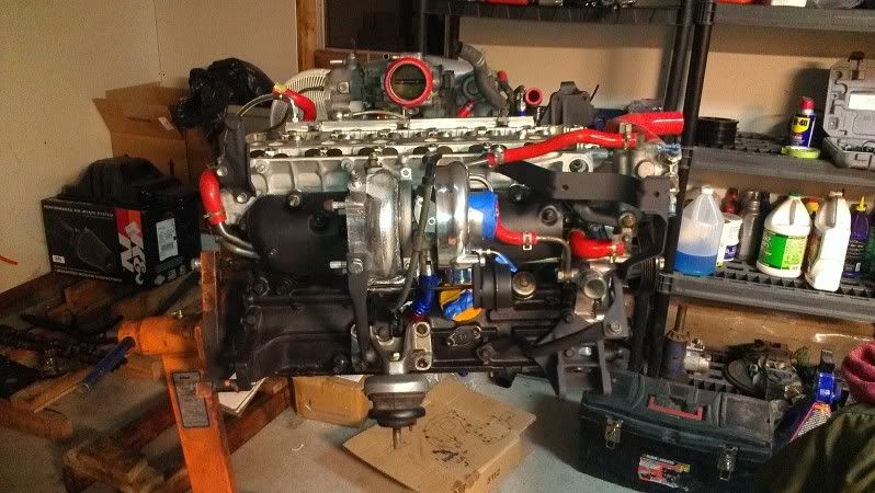

-Mishimoto radiator w/electric fans
-57 trim CT-27 w/ceramic coated exhaust housing

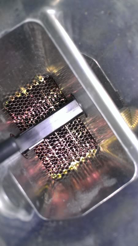

-Lexus MAF

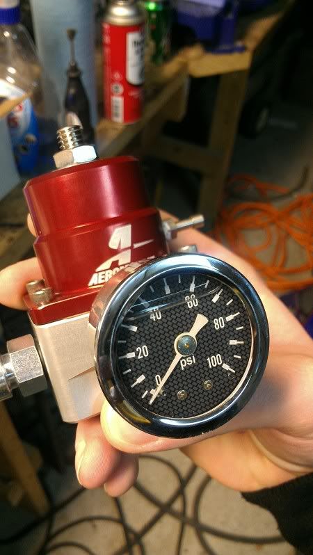

-Aeromotive AFPR

Cometic MLS HG
Eagle rod and CP piston

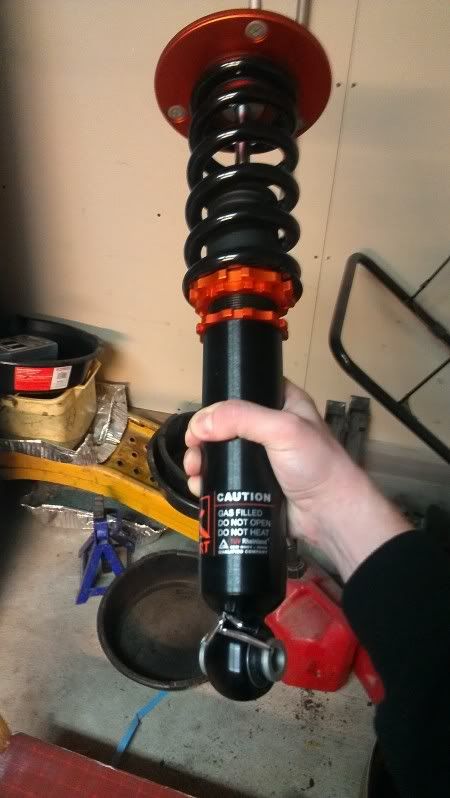

Ksport Kontrol Pros

AbsoluteSpeed;1886024 said:
Looks like a solid build and a great start so far :bigthumb:
I have yet to see anyone use the K-Sport coilovers. Let us know what they are like.
Thanks! I'm definitely excited to see how the coilovers turn out. I'll try to do a write-up on them if I get time.

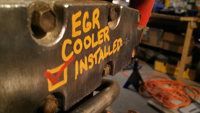

mstgeer;1886917 said:
Don't forget to install the EGR cooler...

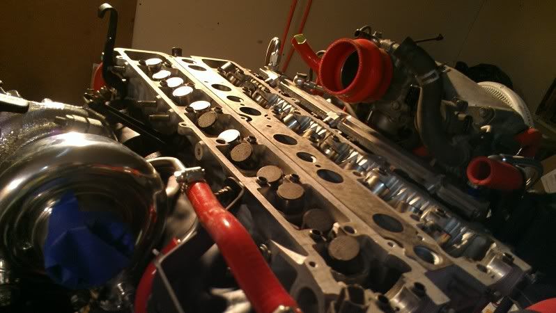

ROFL.... I'm said builder of this engine. Since those pics were taken, the EGR cooler has been installed, intake runner, RC injectors, fuel rail, as well as misc. brackets and lift hangers. :thumbup:

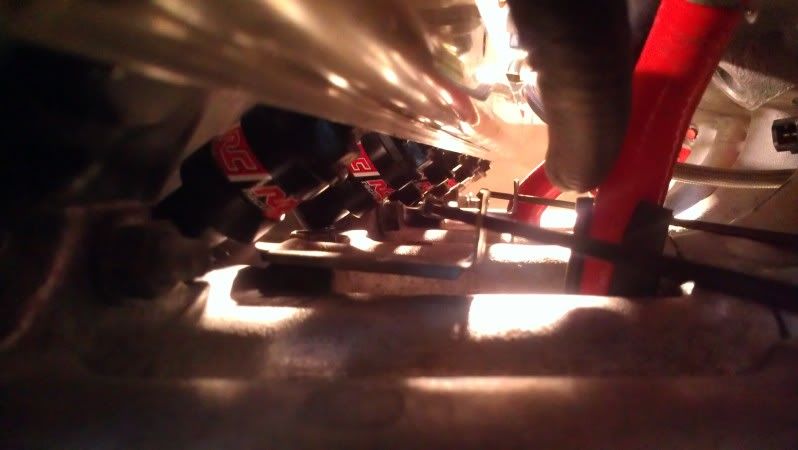

I can only imagine how fun of a job that must've been. I mocked up his turbo today and made the softlines for the oil feed and return that will be replacing the factory piping. This should be an extremely fun car when finished.

mstgeer;1886935 said:
The only reason it appeared to me is, I just replaced the cooler gasket with the engine in the car... fun times!
I can imagine that was quite the task. :aigo:

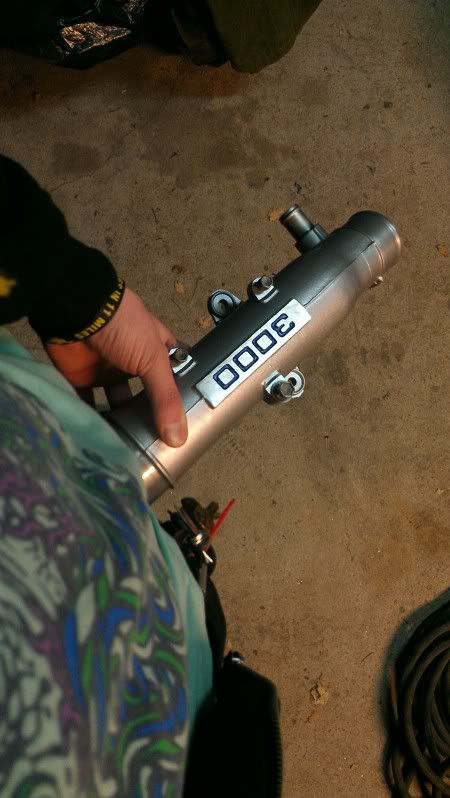

wow. thats one of the cleanest builds i have seen. definately the way i wanna do mine. i would get rid of the intake pipe from the throttle boddy though. i believe its a bit constrictive if i remember correctly
Glad you like, I'm having fun with this one. Michael is a great friend of mine, so I'm taking things even more slow than usual to ensure top notch quality on everything. I am a bit of a perfectionist when it comes to things that I have my hands in. Especially when it comes to Cars.
I think for now we're going to leave the 3000 pipe as he's only going to run low boost for the first while, then when he gets a FMIC setup, we'll most likely be deleting it. :( I spent a good bit of time painting it, inlaying blue lettering, and then filing the surface of the lettering to give it a brushed look. It's definitely really nice looking. :thumbup:
