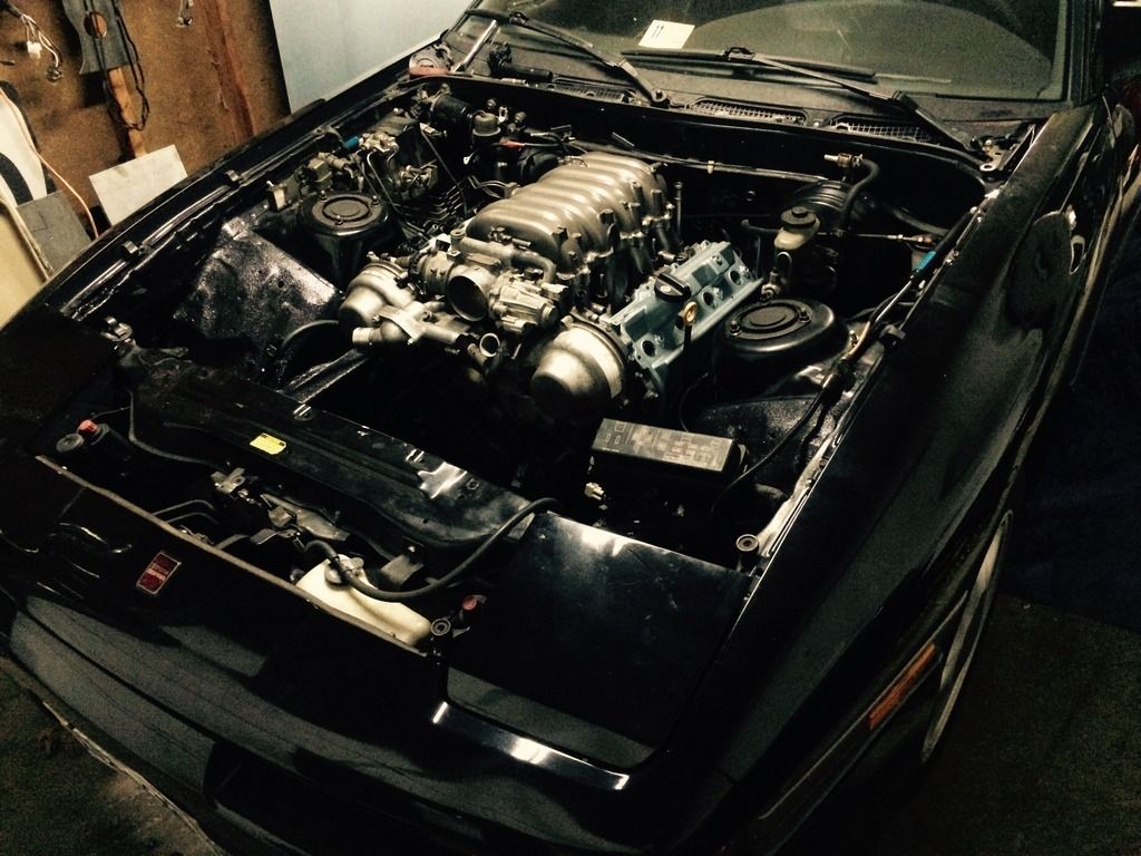

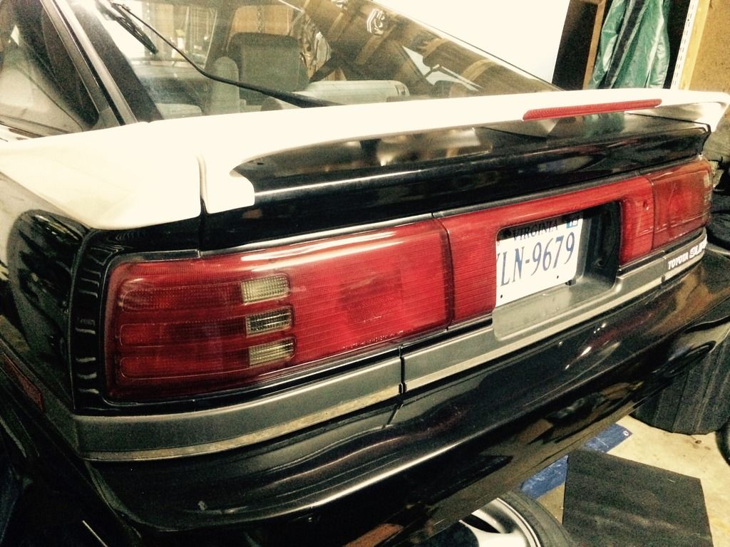

So... After a 2 month setback due to issues with the 1uz/w58 adapter plate I received, I finally got back to work on the supra. In the meantime I did find a nice 3 piece spoiler for sale on craigslist and took the 2 hour drive from Richmond VA to Raleigh NC to pick it up. I hated drilling holes into the quarters but I love the look of the spoiler.
Since the supra has been resprayed recently i found a duplicolor repro paint that's a perfect match. Even down to the micro multicolor flakes.

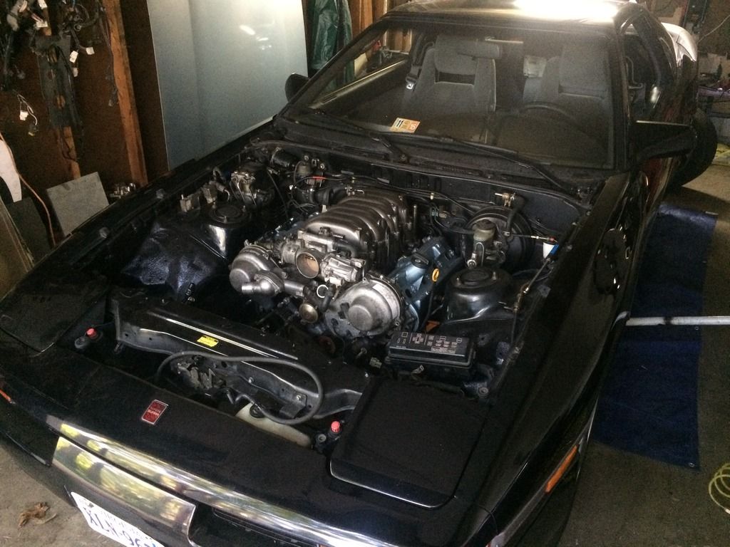

I chose a new vendor (xcessive manufacturing) for my w58 adapter plate and am very happy with the product and customer service. I bolted it all up to get things ready for the test fit.

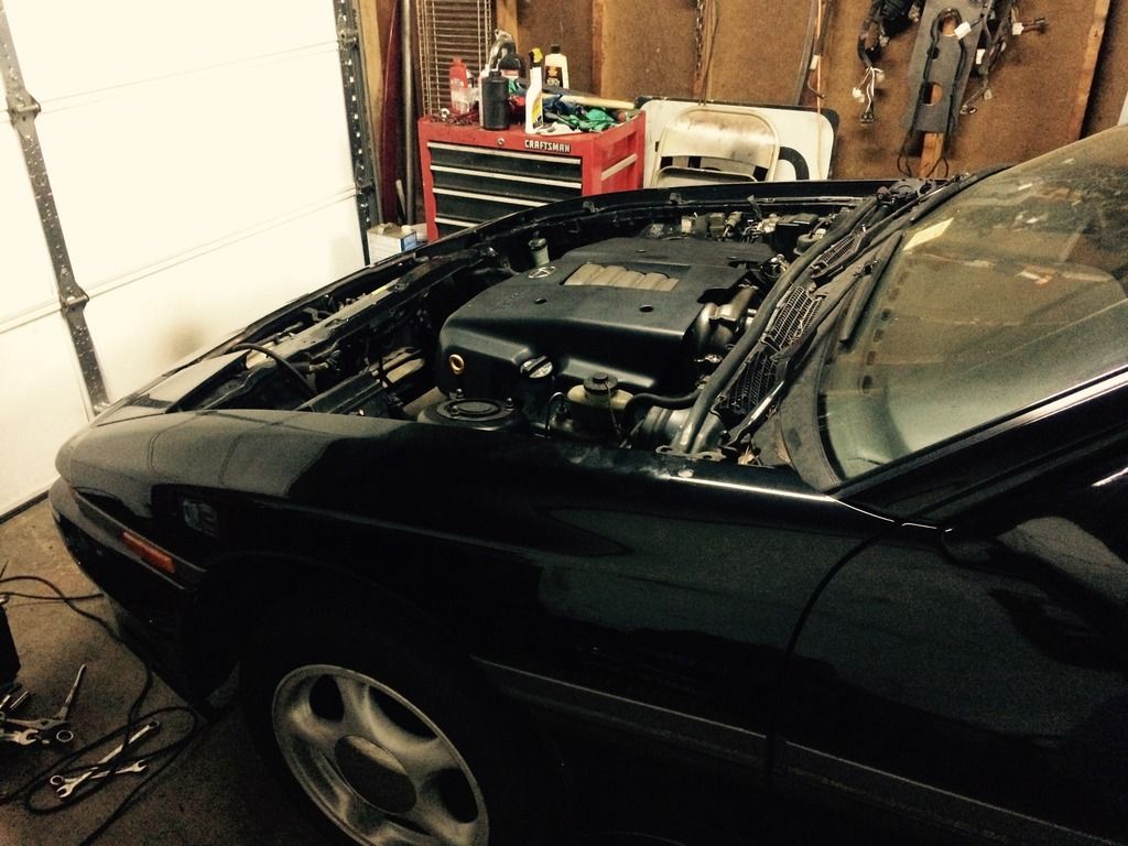

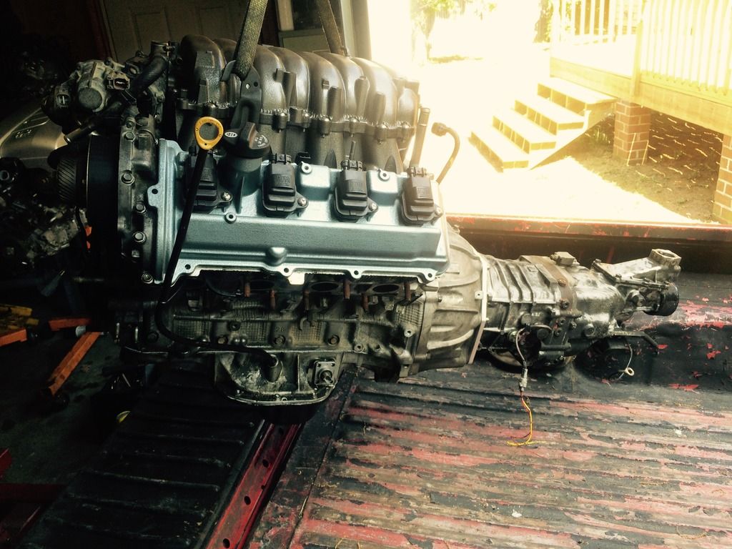

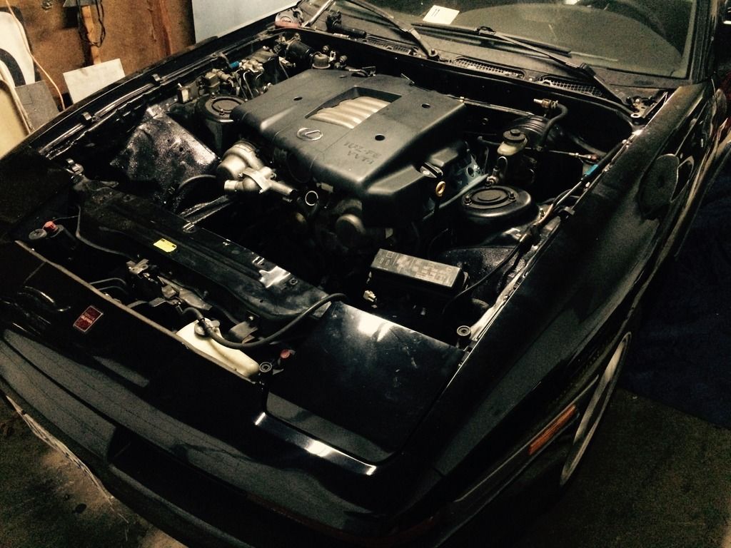

The engine is from a GS400 and came with a front sump. Ofcourse that will not work in the supra but my 3uz from the LS430 has a rear/mid sump so I swapped the oilpan assembly over. A sc400 oilpan would work also but the bolt holes in the upper pan will have to be opened up from 6mm to 8mm. easy to do in little time.

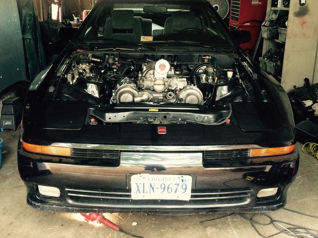

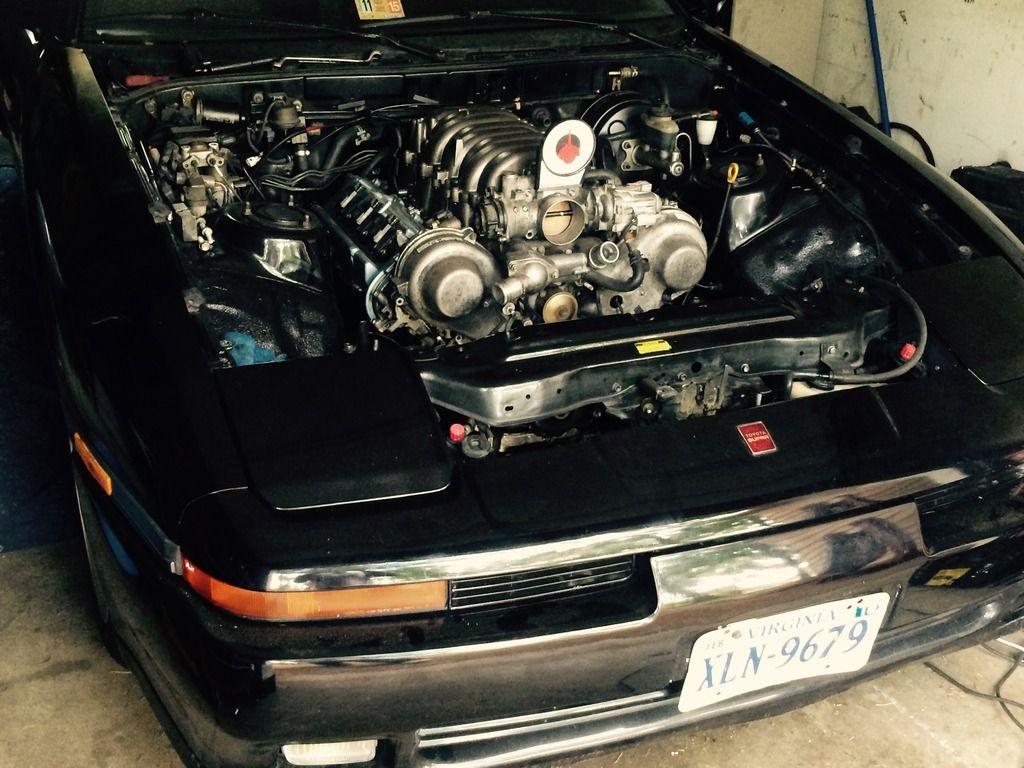

I dropped the motor in and installed the trans mount in it's original location. With the engine sitting directly on the xmember the valave cover just clears the booster. Of course it did not clear it after I made the motor mounts.
I also had to massage the passenger side firewall to clear the head. The motor sets back nicely near the firewall. I built the passenger motor mount with the top and bottom steel mounting plates from the original (broken) 7m motor mounts and 2.5" heavy wall exhaust tubing. Works well. everything clears the hood.
A few more shots.

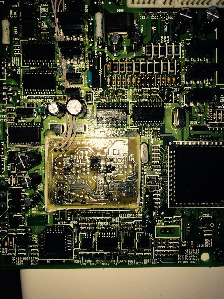

My jailbroken ecu also arrived from Russia.
A circuit is installed to bypass security. Can't wait to tests this out..
