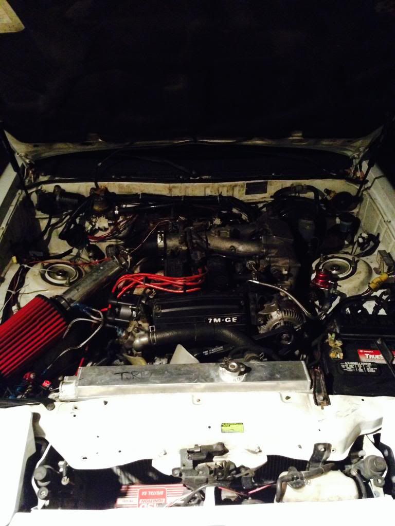

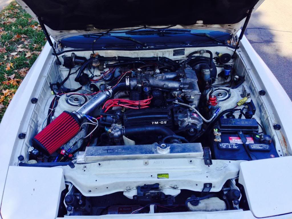

You know what's next... 150 shot!! You know you're going to do it.
Very nice times for n/a. There's alot of turbo guys here that can't do that. Do you have a mod list you'd like to share with us?
ricerkid
Jul 8, 2009
57
St. Louis
Engine
Wiseco Pistons
Cometic HG
ARP main studs, head studs, rod bolts, flywheel bolts
Balanced Crank
Balanced Rods/Shot Peened
Clevite Bearings
10.6:1 compression
Pacesetter Header
Megan Racing Exhaust
Gutted Cat
ECU/Ignition/Fuel
Megasquirt 2
MSD 6AL
MSD HVC2 coil
Magnecor Wires
Aeromotive Regulator
Walbro 255
NGK BCPR7
AEM Wideband
Driveline
Competition Clutch Stage 5
Weir MAXGRIP LSD kit
Tires
Hoosier QTP 26x9.5x16
Nitrous Setup
Nitrous Express Shark Nozzle
Edelbrock Performer Nitrous Solenoid
Edelbrock Performer Fuel Solenoid
Edelbrock Bottle Warmer
Jetting is 52n & 28f
ricerkid
Jul 8, 2009
57
St. Louis
It was difficult for me. It was my first time ever trying to tune a car and wire a different ecu to a car. It took me about a month to get the car running well. My biggest struggle was getting the megasquirt to read a good crank rpm. I had trouble getting the megasquirt to sync well with the stock VR sensor and trigger wheel. Once I figured that out I had problems with some of the settings, but it works well now.

rx7 wheels would be nice! The torque gains with nitrous pretty much void lighter wheels in my experience. I put my slicks on and ran without nitrous and the car went slower then on street tire without nitrous. The car traps the same on street tires and slicks with nitrous(assuming same tune). The slicks are HEAVY with the tubes in them.
