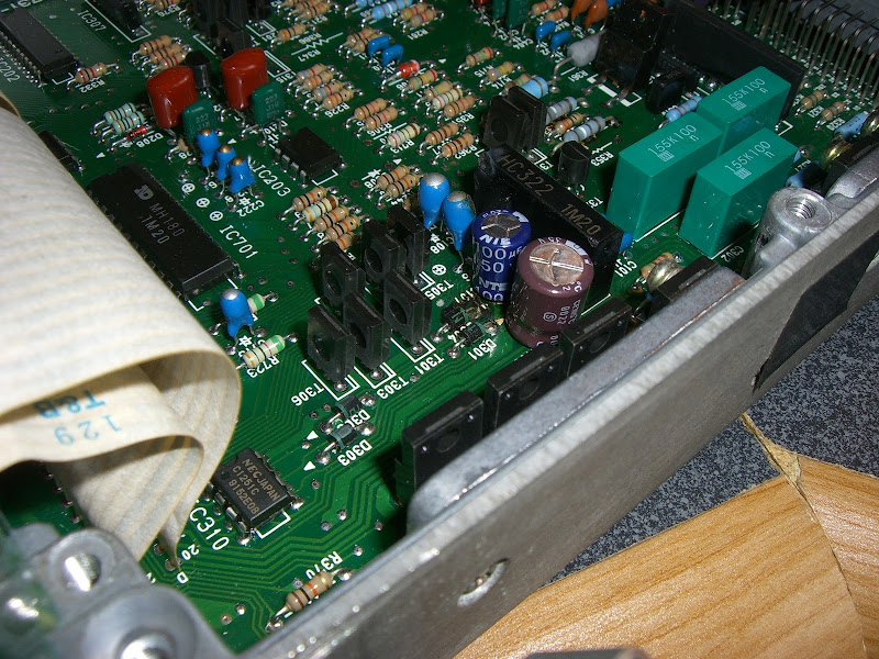

WTF??? help me diagnose this one...

It appears as though the diode beside it and the big black thing (HC322) were effected by the electrolyte compound in the capacitor as well, they are looking kinda burnt... are these parts replaceable?

Mine blew the same cap and I replaced it with the another with the same tolerances. drove fine for a while and then Poof blew a diode on the other side of the board and now she sitting on jackstands waiting for the standalone to be finished. I spoke with numerous people about getting it fixed and I was told that seeing as the 1JZ ECU is a POS that it will just end up doing it again down the road. Yes even the Mines ECU's do it. I went with a Megasquirt 2 and it is being assembled, should fix all of the problems but there are better and easier ECU's out there.
