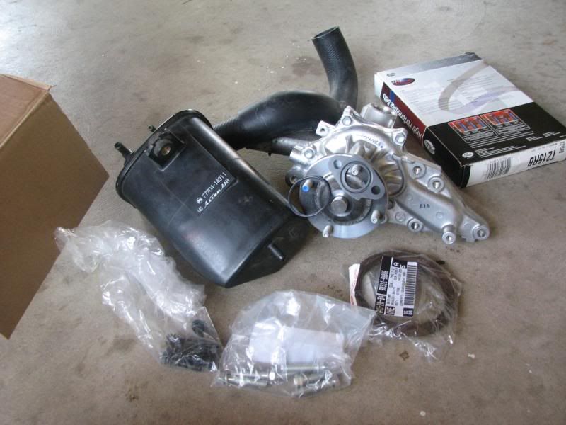

yea you gotta get the rear housing i thought that just the front part would fit lol didnt work out so well i got the new pump with the rear housing from a sc300 once i got that everthing bolted right up

turbo / na clutches are all the same. the fan is whats different. for some reason i read your thread funky.. the pulley will work for the gte or ge pumps 1 or 2 jz.

The pullys all change over.
The clutch fans will also from 1jz-, 2jz-, ge, gte
The soarer is the same I dont think you need both housings for the 1JZ soarer engine because they dont use the hydro fan.
If you have the hydrofan you need the rear housing also.

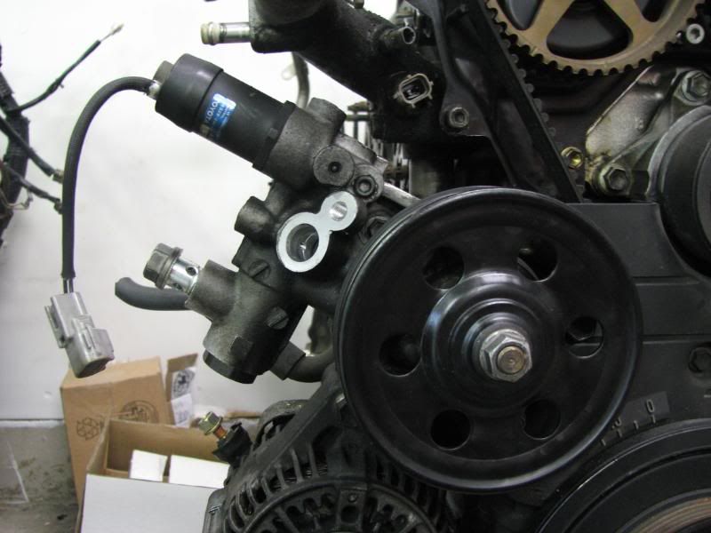

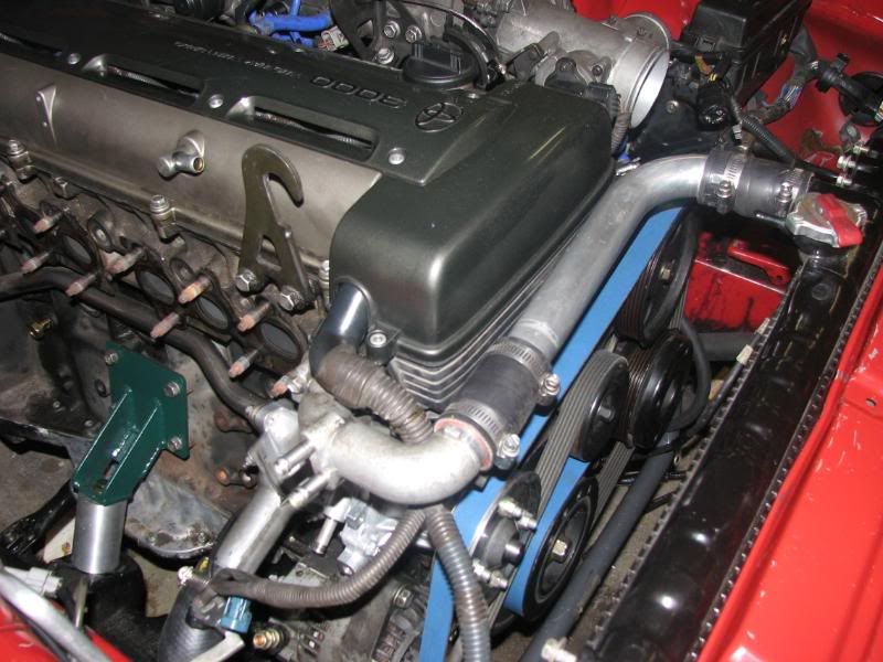

this is probably the most retarded question ive ever asked but to just confirm which one is the mechanical or hyrdo fan. im confused to which one it is.

tehee:sarcasm:
hydro
mech.
mech on engine
