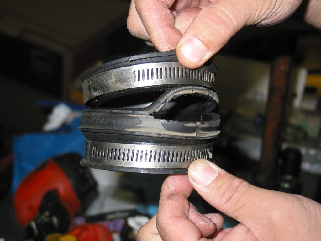

Check the coupler from the 3000 pipe to the Throttle body...mine looked like this: (it was fine at idle, but boost would force it open, and start leaking, couldn't tell it was cracked unless you looked at it VERY closely.)

I took the 3000 pipe apart, and there it was.. laying there loose as Jenna Jameson; my silicone coupler.. It wasnt torn, it looked as if it was tight, but as soon as I went to loosen the bolts from the clamp, they were already loosened.
I bought a new coupler and replaced the old one sit is was deformed from the heat. I went out and I boosted again normally =]. THANKS ALOT BRO! You saved me! I owe you one..
