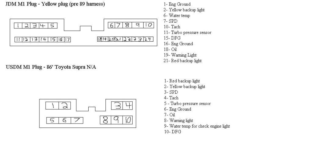

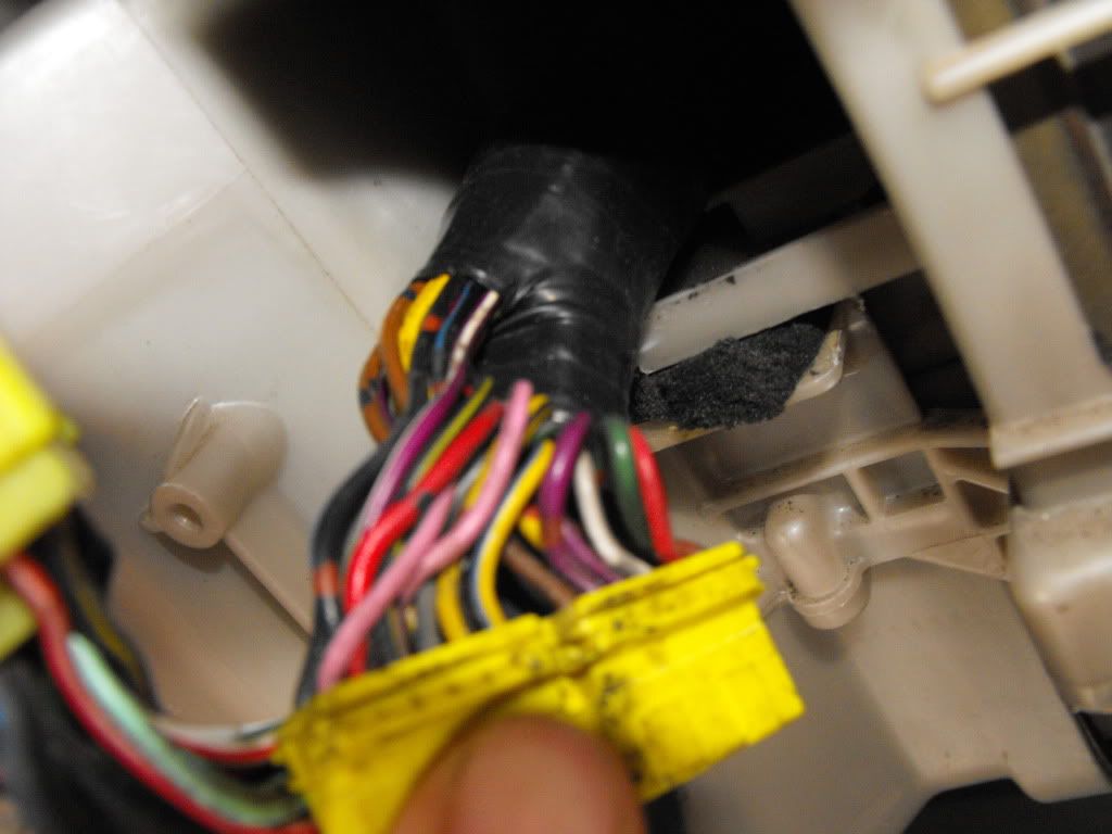

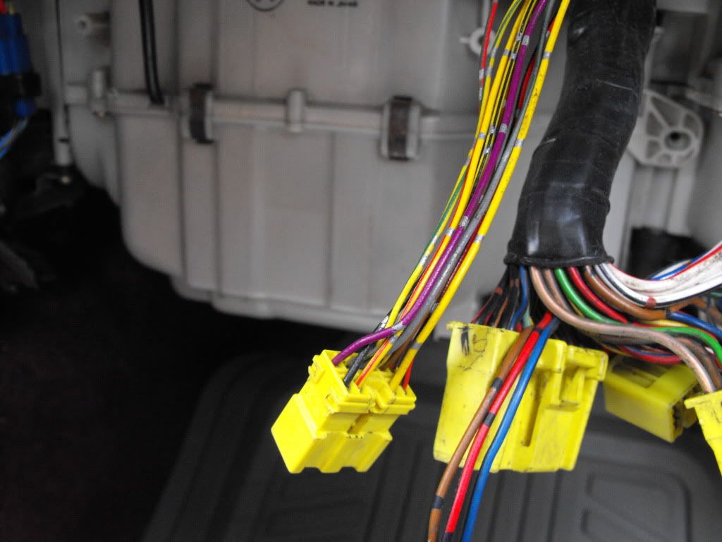

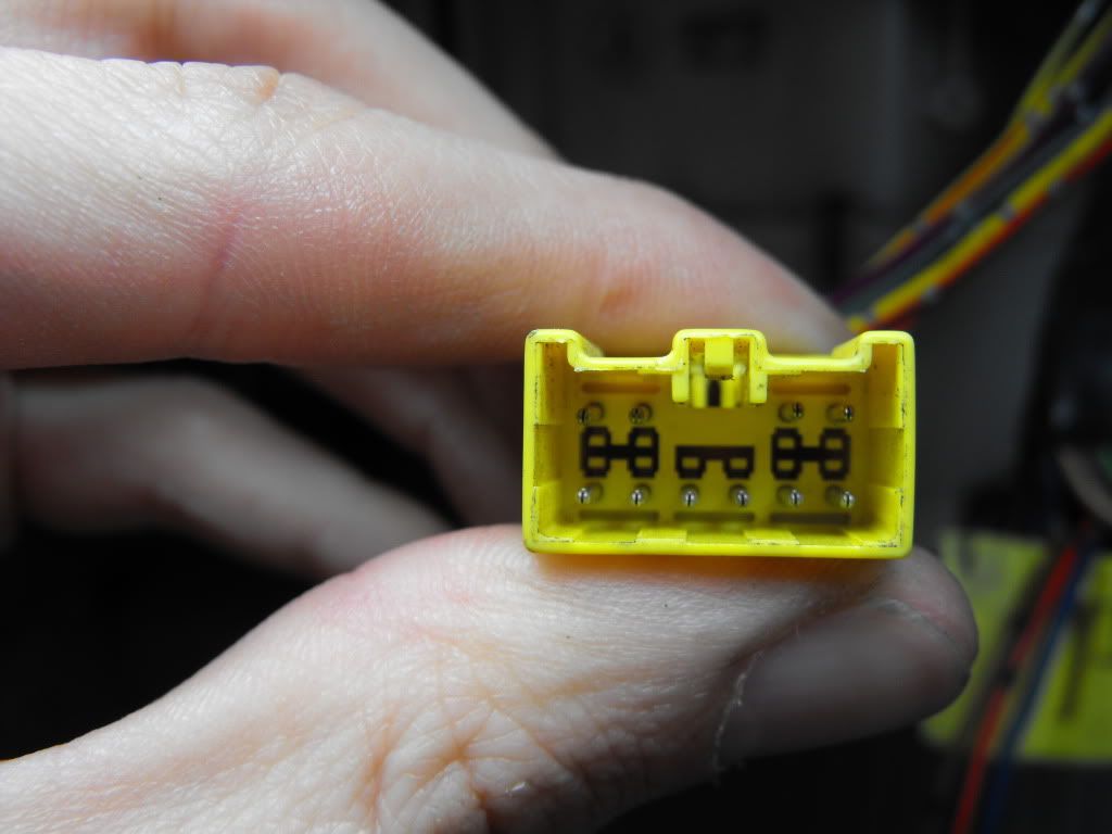

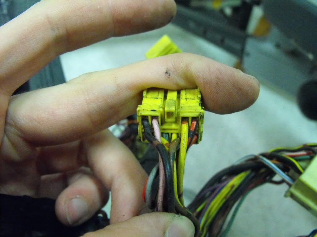

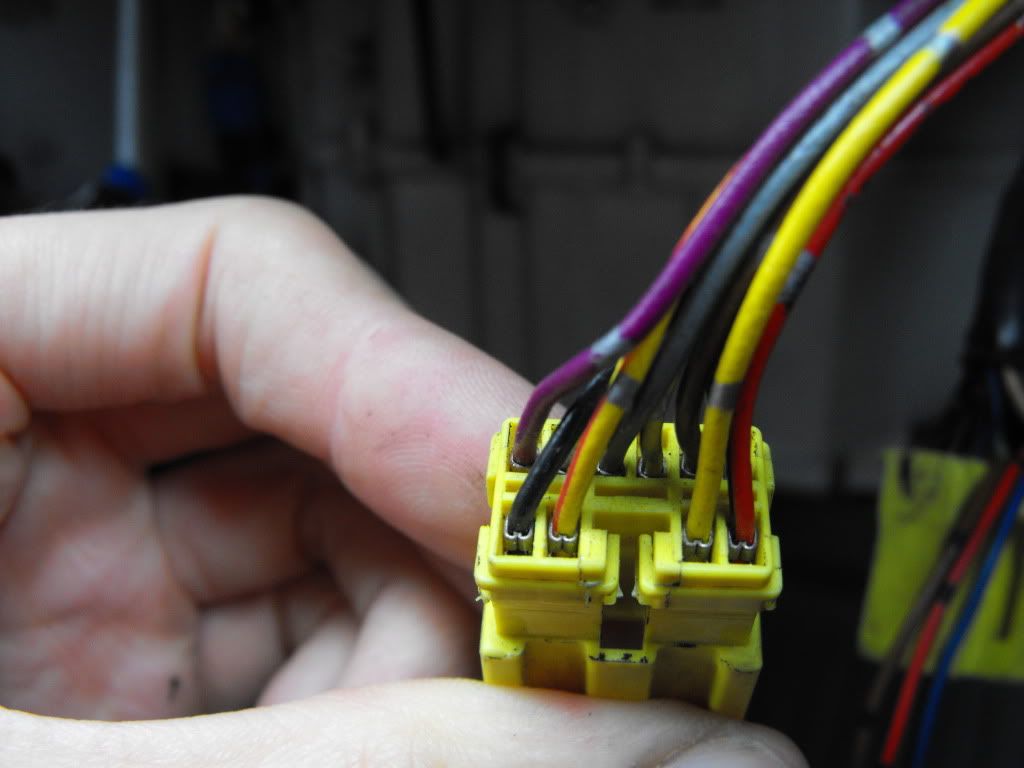

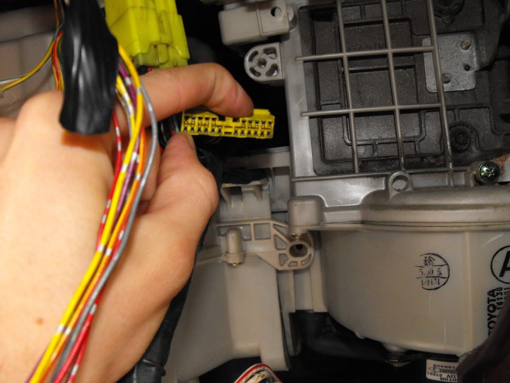

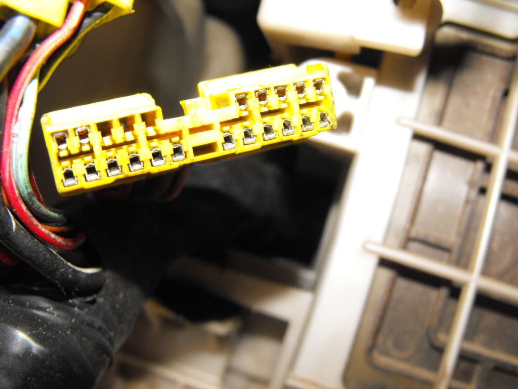

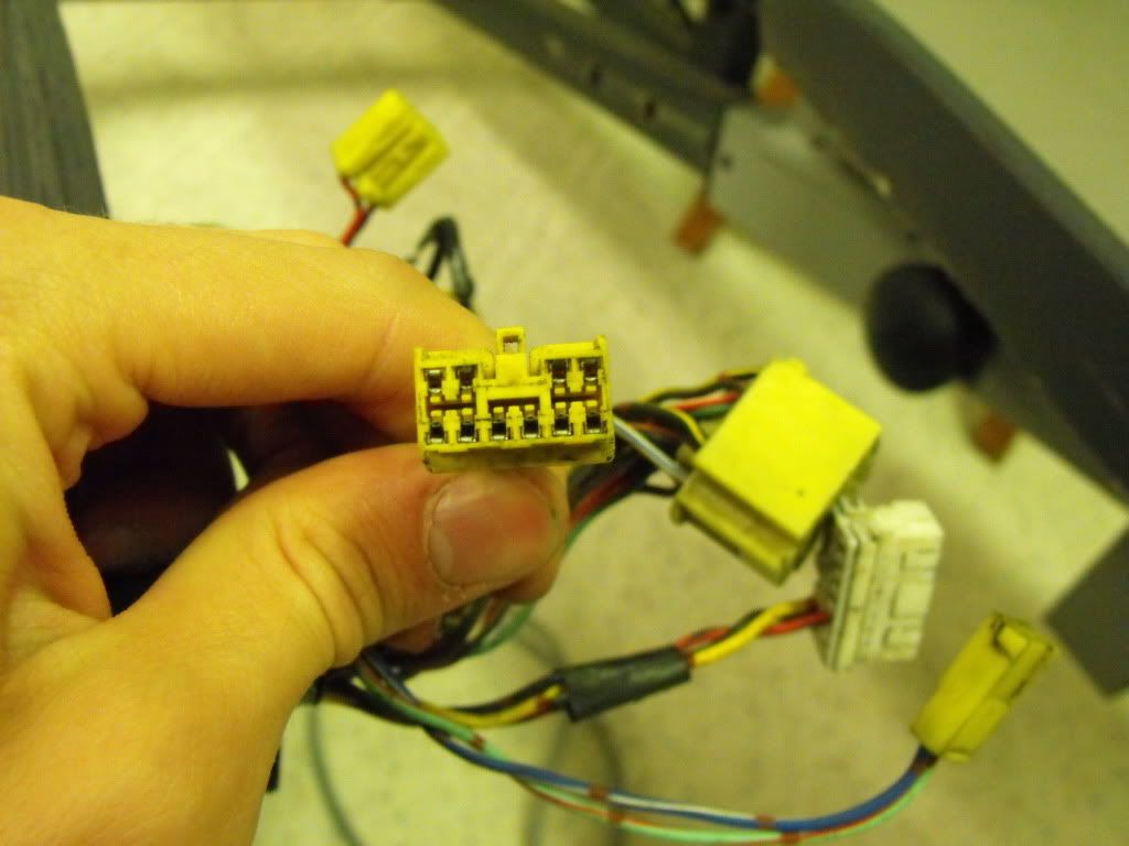

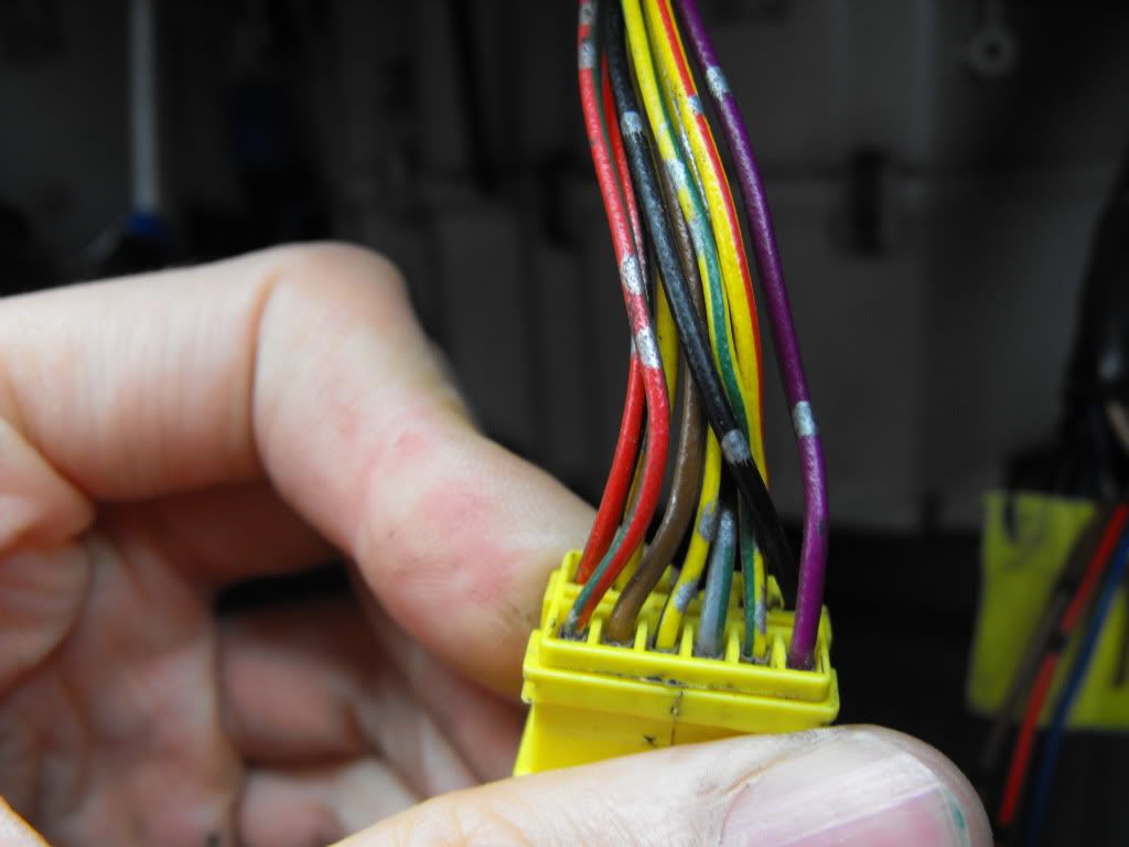

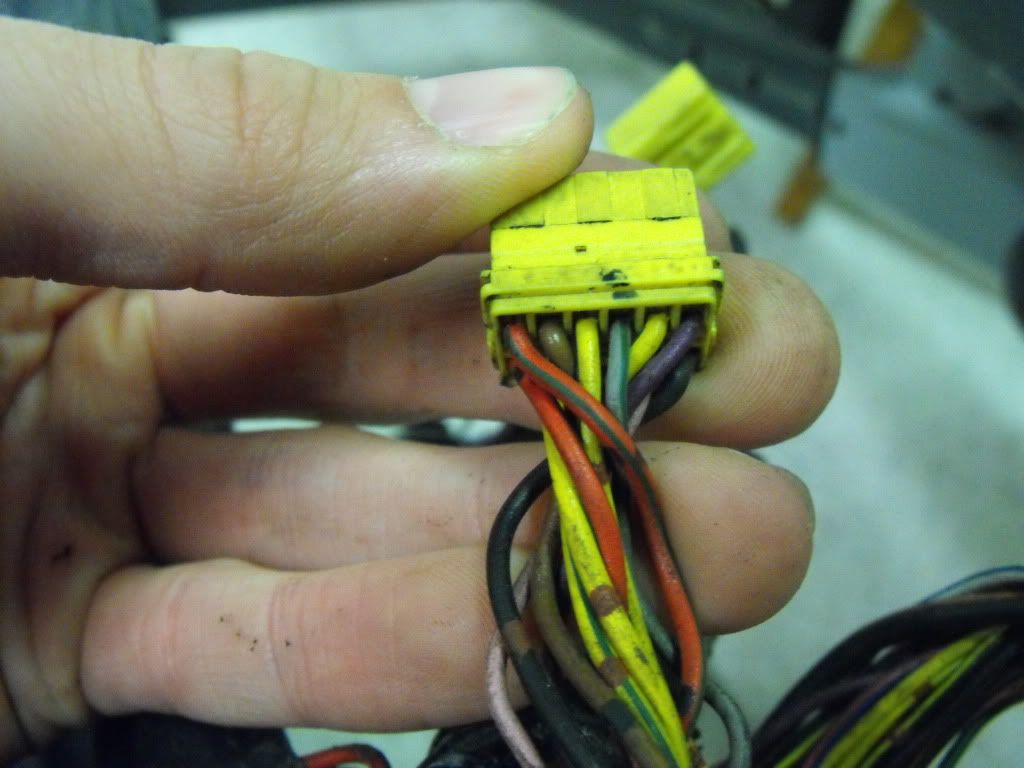

I'm installing a new wiring harness in my supra. My body is an 86 supra, and the year of the harness isn't 86. My problem is that a plug on my wiring harness doesn't connect to the plug on my body harness. Now I have a male plug that is compatible with it from my old harness. What I think I have to do is just figure out which wires I need and install the male connector on those wires. In looking for the plugs I can't find the plug (24 pins) in my TEWD. Not sure where to go with this. Thanks in advance.
Male connector on my new harness:
Female connector on my body harness:
Male connector from my old harness:
