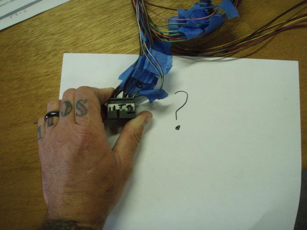

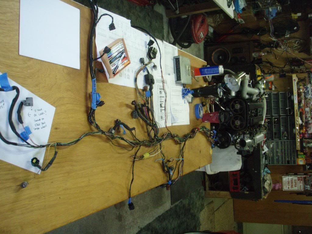

well I assume that you are talking about the two missing "body plugs" . There is not many connections that I made.. I took my entire harness and laid it out on a table and started at each plug omitted every wire I didn't need to run the car.
The extra plugs are the Trac, Diag box, Ac wiring,Hydro fan crap. Once I got rid of that. I didn't have much left. Are you planning on using TRAC? if so start at the secondry tps and trace wires to plug. The only way I figured it out was to trace the wires. Are you trying to figure out what plugs are the IJ1,IJ2, IK1, from the soarer harness in ma71 thread? It is not applicable.

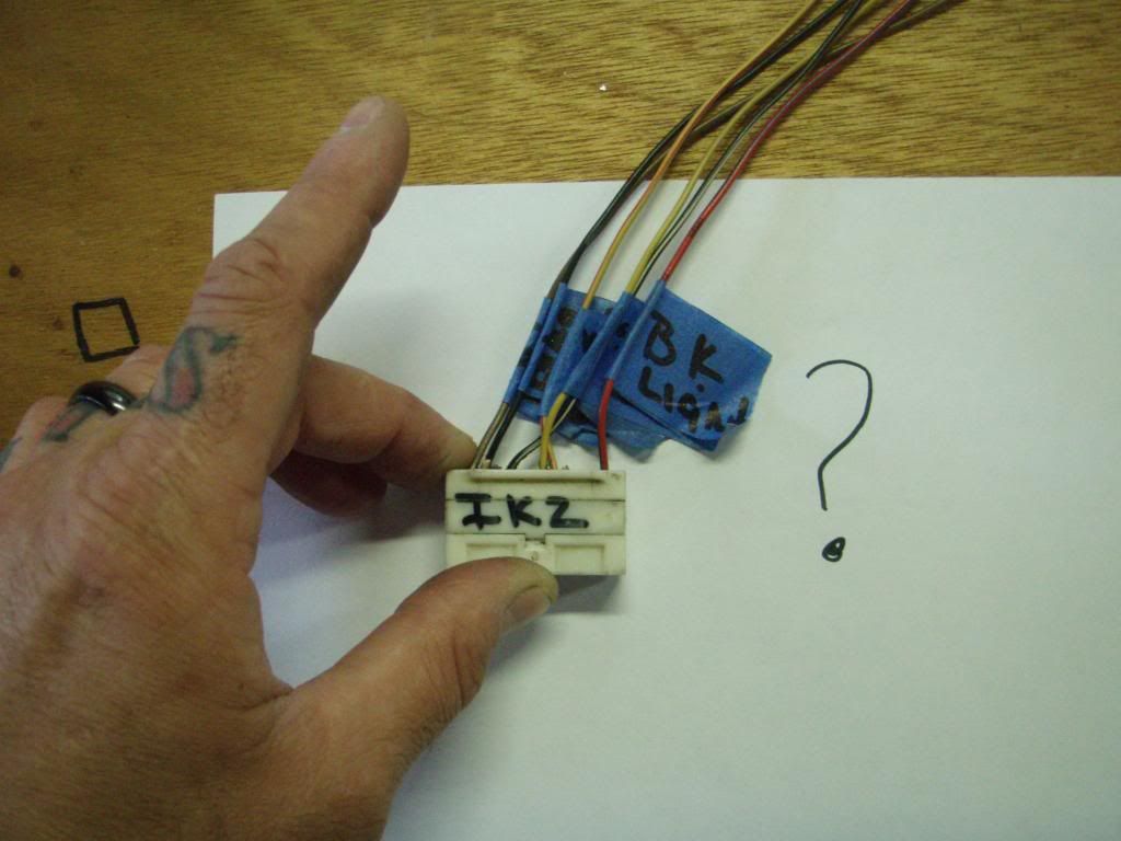

I just wanted to list what plugs do what for myself and other people searching.
Yes IJ and IK are the plugs I wanted to decode.
Is the white IK the Dash or the Gray IK? Which one is the trans plug?
Basically, is the Chaser harness wire colors and plugs the same as soarer?

Those plugs do not exist on the x90 harness that is what I am saying. The plugs are NOT the same. The two large gray ecu plugs are the only ones that are the same.
If you want to decode the plugs. strip the harness and trace the wires. Attach the harness to the 1j, Label plugs, Take a board and staple zip-tied plugs and trace the wires from plug to plug. This will answer all your questions.
Their are like four plugs that are left.
Most of this was discarded
Gone as well
A lot of this was from the diagnostic plug. I only kept the wires used to check codes.
This is what you have to do to figure out the wires

^ This oh yeah I am golden . The car has been running for a month now. You are right a voltmeter works better. I wanted to remove unwanted wires and repair any damage to wires. Now it is all neat and clean. Most if not all of the info I got for this was from your wiring guide.

My 1jz runs as well. I got the engine harness and ECU wired up. The only thing I am missing is: Auto Trans plug wired in, Dash, tach, speedo, etc.
There is only one plug of the jzx90 harness that plugs into the sc300 body harness, and I had to repin it.
The Square gray one w/ b/r , b/y that powers the coil, sensors, etc.
I need to find sc300 body plugs for IK and IJ, and wire them up I guess.

Do IK and IJ change at all between supra and sc300? Probably not, but the chaser IJ and IK look almost the same, except the they have a little more meat on the outsides and doesnt quite fit in the socket. The pin arrangement is the same, but the plugs are wider.
