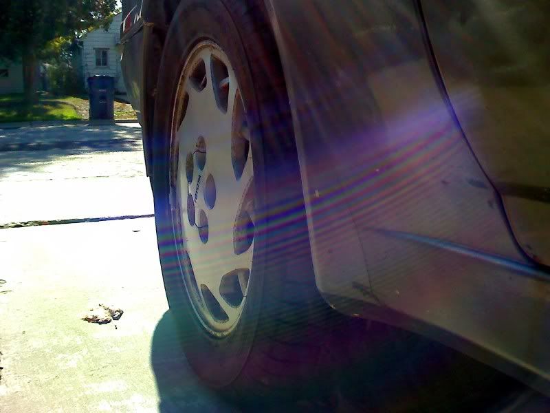

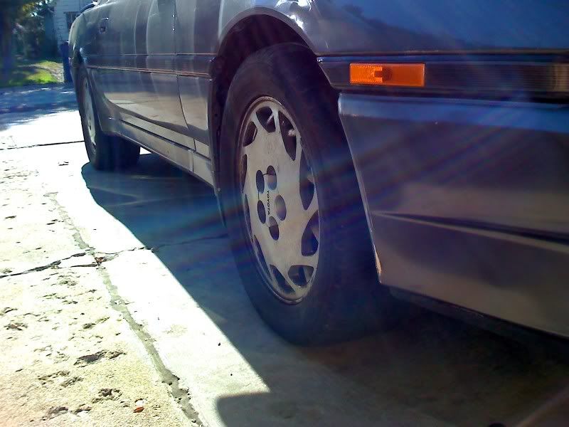

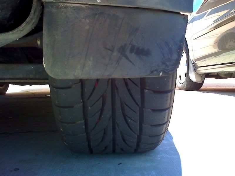

I dunno, I have PM'ed NeatOman once and he responded this way
NeatOman said:
ValgeKotkas said:
Hi, I was reading the brake rotor thread and noticed you said you run/ran 245 tires on your sawblades? Right?
So I though I'd as, whether you have a pic of the tires on the car. I'm just wondering, how wide can you go on the stock blades:icon_bigg ( don't want to buy new rims:icon_razz ) and how does it feel? Don't so wide wheels seem dangerous or smt?
Thanks a lot:icon_bigg
Those are Fuzion ZR1 245/50/16, so they are taller then normal (225/50/16). For stock hight you could try to find 245/45/16. If you go with 50 it will have 3% increase in Diameter.. so if you're going 50mph you will really be @ 51.5
The foot print is about 8.5 inches, and has a fairly strong sidewall.
I hope he doesn't mind :D
