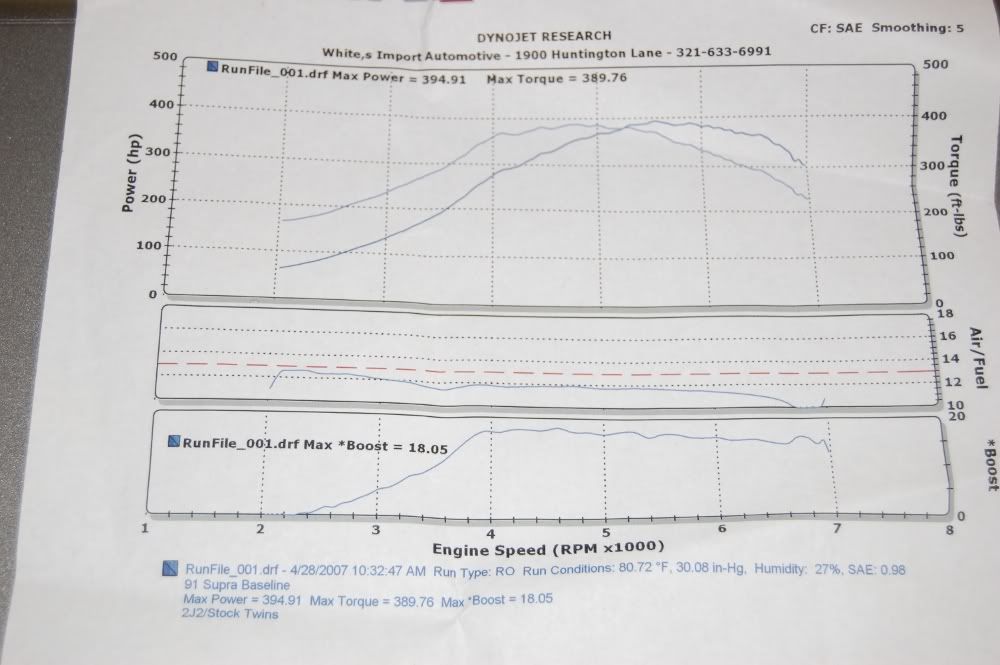

Yes, jdm turbos suck, usdm turbos are better. JDMs will max out about 400-420whp where as USDMs will max about 450whp. If you plan on staying with the twins for a while go USDM. If you want a single turbo eventually just stick with the JDMs till they blow and go single, or just go single from the get go.
Fwiw, I made 400whp (394 really) on (usdm) stock twins @ 18 psi (falling to 16) on 93 octane in my old 2jz mkiii
