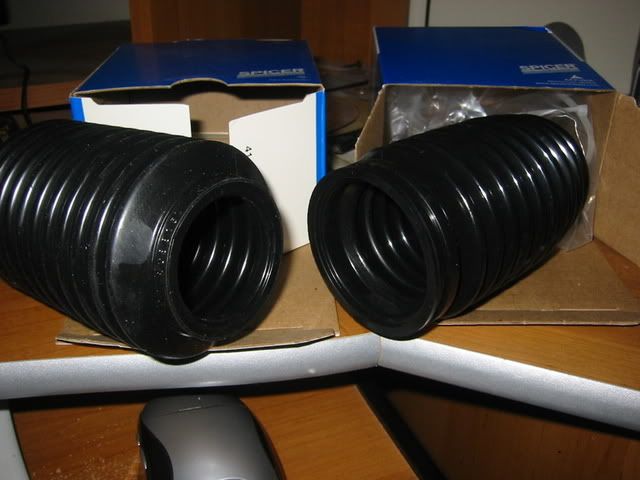

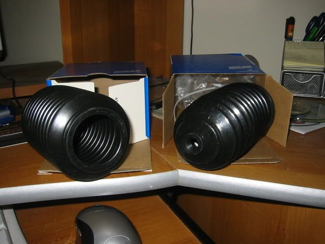

Well, It looks like both sides are different:
The part numbers
The top of each
Bottom
Hopefully, I'll get to replace all the tie rods and these boots this week.

FYI-
The driver's side boot (the one with the small end) does NOT fit properly.
The large end is too large, and I had to tighten down the zip tie to keep it on.
I dunno if it's the wrong part altogether, or if it's for a different year.

Well then, I'm confused, Jeff.
I have an 88 NA, and they are very different from each other: The passenger side inner tie rod incorprates the simmy damper mount, and because of this, that side uses a boot that goes from the inner mount to the damper mount, which has equal width ends. This one covers the steering rack end where it moves in and out of the steering rack case. Outside of the damper mount(looking towards the outer tie rod), there is a tiny boot which covers the ball joint of the inner tie rod
This pic represents Both tie rods that I received
This pic represents what was originally on my car, and what I needed to get. Notice how the body of the tie rod is threaded for the installation of an outer lock nut, to hold the damper mount in place.
As is, I've had to remove the shimmy damper for now. Haven't really noticed any change to the steering feel, though.
