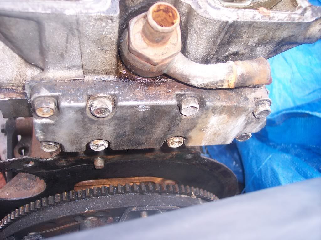

ok here are my motors one has bad rod knock and the other is a low mileage jdm why do they look diferent in this spot what do i put here?
ok here is the new one
and here is the old one why the difference
thanks

so does that mean i really did get a jdm motor? and should i swap that plate over to the new motor for my emisions?

Swap all EGR components over to the JDM engine, along with the EGR cooler(That plate on the back of the head) Or buy block off plates for the EGR(Bad idea if you need to pass emissions)

EGR remove blocking plate from inlet and rear of head slap on ebay for EGR delete bolt on your EGR goodies
Dont forget that heater water pipe is on the wrong side also
Would hate to have to change that in the engine bay :3d_frown:
Thats what hes got JDM EGR block off plates :biglaugh:
