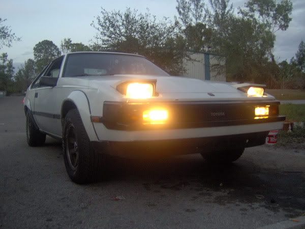

tekdeus project is similar to what I was thinking.
Maybe not quite that low, but something along those lines. A forward mounted lamp system (now re-thinking about using modified Sylvania x1010) which will illuminate at a correct height when the Supra assemblies are partially opened.
The lighting project will be on the back burner while the engine phase is being worked on. Its going to cost quite a bit of money to get it running properly so all time and work and money will go into thatw portion first.
HIDPLANET
89 1JZGTE
They are an auxillary lamp by design, but if you trim the belly shield it can easily surpass the intensit and distance of a main beam without glare. They come stock with 5000k which would be swapped out for 4100k bulbs. I really dislike blue output.
