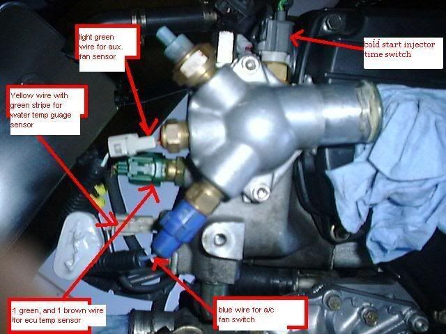

What sensors are on the thermostat Housing

I know the BVSV is on there but that is the and a temp sensor I need to know all the sensor ( In particlucer ) What is the GREEN one, I broke the clip and really need to know!, but If you could tell me what everyone is that would be great!

I found this searching this site a year or so ago... Hope it helps.

Thank you so much! that clears up everything wow Do you have more diagrams of others things cuz wow thanks you!

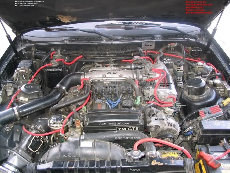

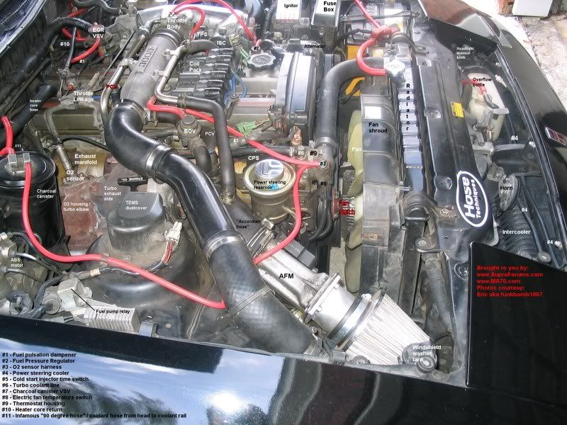

Ok. Not sure what you mean by other things? Here are other two other pictures listing several (if not all) items under the hood of your MKIII Supra Turbo. All other diagrams, information I have you can easily get from the online TSRM. **Also, these are not my creations... I found these by searching on this site.

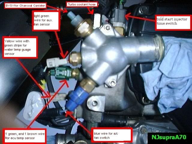

isnms;1000097 said:
credit the guy that labeled this pic - NJsupraA70
and identifies the other things on the thermostat housing
Thanks, I wasn't sure who the original author was.
shaeff edit: so I don't bump an old thread- NJsuprA70 was NOT the one who made this diagram, it was Shawndude. NJS just slapped his name on it. Shawndude was a super oldschool member.
