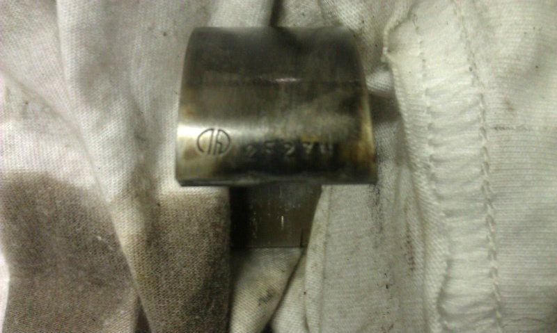

Anyone know what brand bearings are these? I've tried googling* the number on there (2F27H) with no luck. Here's a picture. Any ideas?
Thanks!

Nope no number. I'm trying to figure out if these are std...before i pull out the gauges heh..

those are indeed Taiho, but they made all different sizes.. it depends on whether they're marked 'STD' or a code to equate to -/+
to quote IJ:
IJ.;1608287 said:
"Select fit bearings"
It's a standard Toyota thing, they've been doing it forever to allow for +- tolerences from their machine shop.
There is usually a chart that tells you xx Crankpin size and yy Main tunnel or Rod size will = zz Bearing Shell.

Toyota used a lot of different sizes to make each bearing fit perfect but a standard bearing usually will replaced a stock one depending on what happened to the motor.
