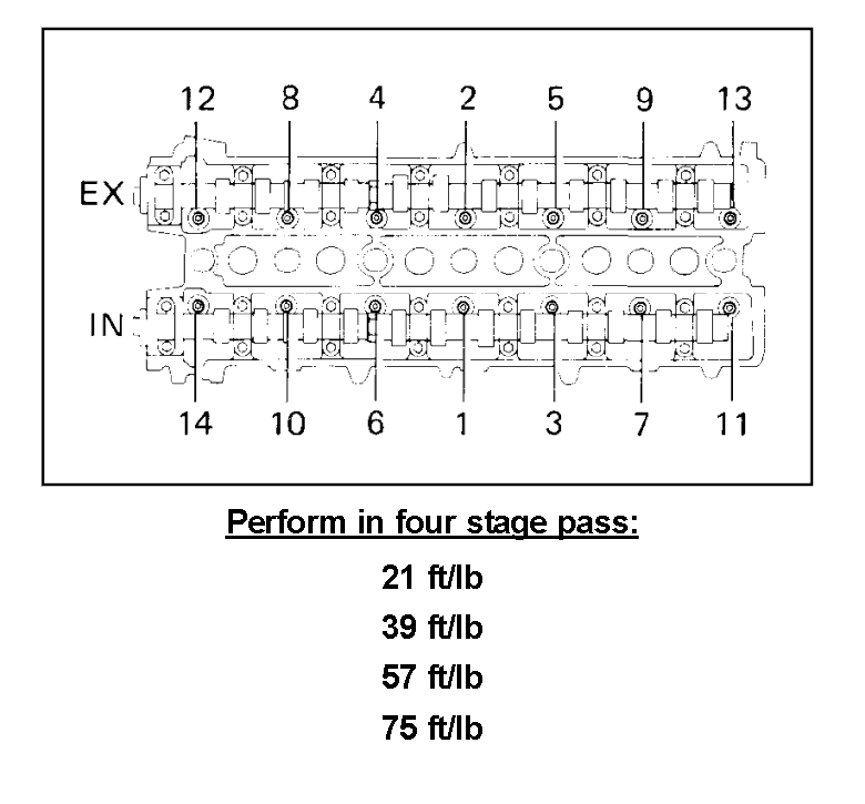

what is the torque pattern for the head

Also, once you have the final torque down, if you use moly lube you can redo it about 5 times to get the most acurate torque readings, but that's just me being picky about how accurate the torque on the head is...

I'm geusssing its the same pattern for a retorque, such as breaking it loose then torquing it down to 75 in that order right?

My questions is can you do this to a single bolt after the rest have been given their final torque down? ^ i read the friction section but it didnt clarify.
Im just wondering because i've heard of people replacing existing stock bolts with arp's 1 at a time.
