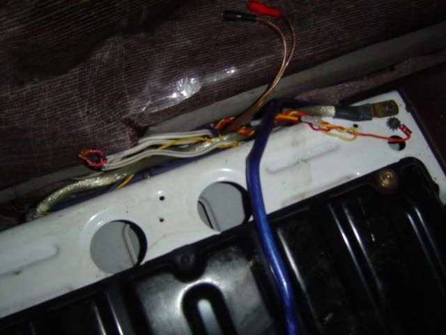

annoyingrob, Awesome that sounds like a really good idea, As well as a good lesson, I'm starting to get car audio more and more. As for the subwoofer, I'm all for it but i need something small enough that i could still put my Targa top in the back. I think i have a little cross over box dealio i got with the car, it's really old though. So your saying a Decent Headunit has built in cross over features? What size amp should i use for the fronts? brand and wattage. What kind of wire should i run from the speakers to the amp? there are a lot of wires running to my trunk like a big fat Monster power cable and a bunch of other wires... not sure what they all are though, I'll take some pics in a little bit.

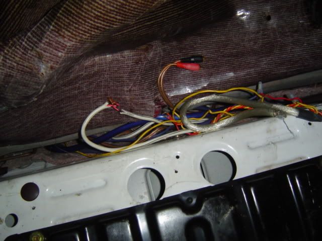

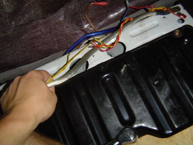

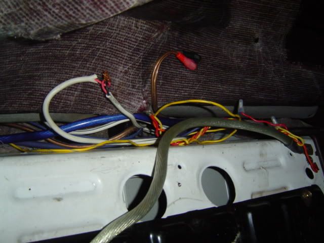

Ok, here ya go, Looks like a have a bunch of wires ran already... Don't have a clue what all the wires are for, Other than the Gian "Monster" Power cable.

the blue and silver wires are power wires to an amp. If they're hooked up or not is up to you to find out. As for running wires to the speakers, 14ga would work.

All that wiring in your trunk was for a subwoofer at one point. That makes it really easy to install one.
