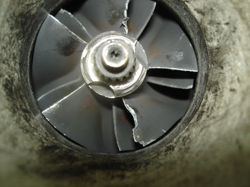

My car is finally on the verge of being fixed. I will list all of the problems that I have with my Supra and I will tell you what parts I have to fix the problem. I need to know if you recommend any other parts while im at this stage.
The motor was rebuilt about 30,000km ago. So take that into consideration. I already have an MHG and ARP's on their, so I dont want to take the head off.
PROBLEMS:
- Turbo has chipped blade, turbo side of engine smokes up and smells awful after a few minutes of hard pulls.
- Accordian hose is cracked and missing chunks all over
- Power steering leak everywhere, ps pump squeels lika a mofo
- small vac leak, I can hear it, but cant spot it
- Timing belt, wobbles on cam gears
- Cam gears wobble on their own.
- Really bad idle (vac hose on bottom of intake pipe, is disconnected)
FIXES:
- Upgraded 60-1 Turbo from miketurbofl
- Cooleeze Intake Pipe
- Good condition PS pump
- Hose Techniques Vacuum Hose Kit
- New Timing Belt and Tensioner
- Good Conditioned Cam Gears
I also have a full gasket set, but I cant afford to have all of them put in. What gaskets do you recommend I have replaced while these problems are being fixed?

Heh, the problem with internet diagnosis... I took from this: "turbo side of engine smokes up and smells awful after a few minutes of hard pulls" that your passenger side valve cover was leaking oil onto your manifold.
Your turbo could just be blown, but that would cause smoke out the tailpipe (unless you had a huge exhaust leak)
Kyle87T
Aug 4, 2005
479
Richmond Hill, Ontario, Canada
The turbo blade is chipped to shit.
It would make sense that oil is leaking on the manifold. I did notice though that after a 200km drive, in the same area, steam was literally shooting out like tea kettle and making a hissing noise.
I think the cam gears are wobbling when I tried to take the timing cover off. It took me a few hours of sledging and breaking the cover and finaly I pulled the thermostat off. So that would be my doing :D.
