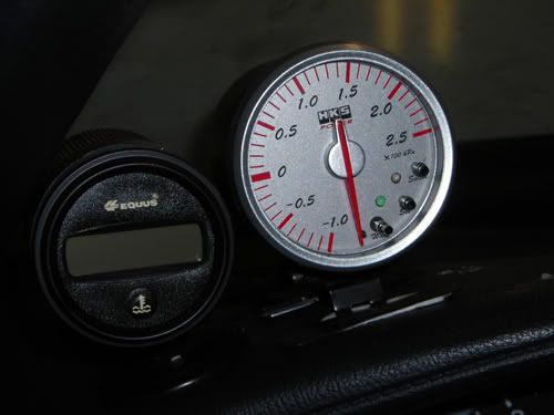

If I may add my experience.
Do digital display, it takes the guess work over minuscule needle movements.
I love mine, and it's hella old school.

Brent, if you don't mind me asking, where did you get that and how much did it cost? Also, anyone have any brand preferences? I'm also looking @ ISSPRO and their gauges look awesome as well.

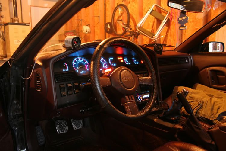

Autometer with electric sender. Drilled and tapped a hole for it on the blank for the thermostat housing. A mechanical one needs the actual coolant to flow to the gauge for a reading. Not what I would choose to do, go electric instead. The gauge is mounted on top off the black plastic cover just behind the steering wheel. Nice and flat there and it doesn't block the display all that much. Pretty cheap, too, and under $50 if I remember correctly.

cap't, can you get a pic of your sending unit? i wanna see where you drilled and tapped.
