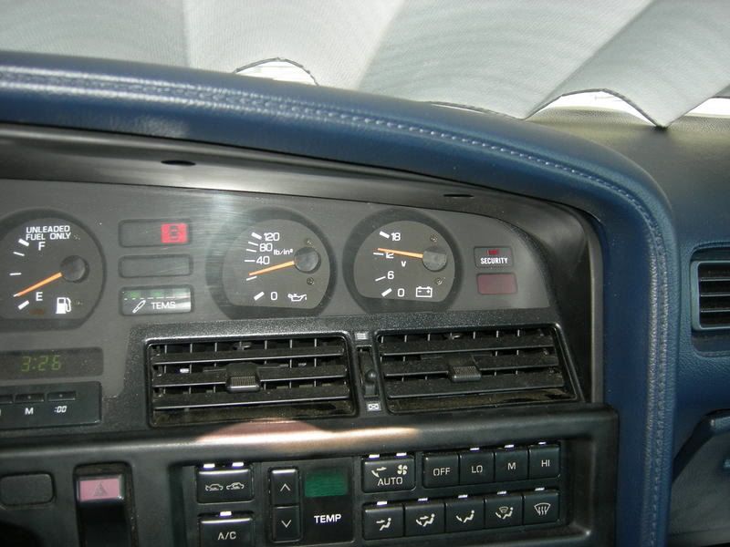

From my SF build thread.
got_boosted said:

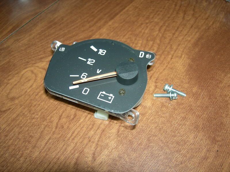

I became unlazy enough today to pull my gauge cluster and swap my factory boost gauge for a volt-meter since yesterday I installed my -30 to +30 mechanical boost/vac gauge. It was easy enough.
Poor Supra. :(

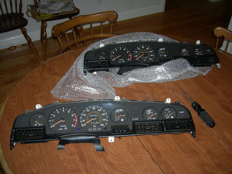

The one closest is my original 91T cluster, and the other is a 90 N/A cluster that will be donating the volt-meter.
Volt-meter out!

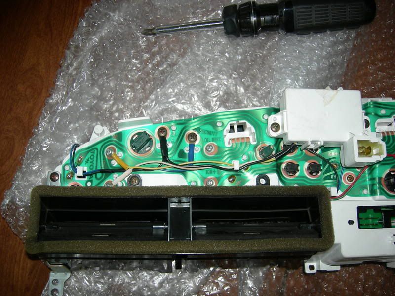

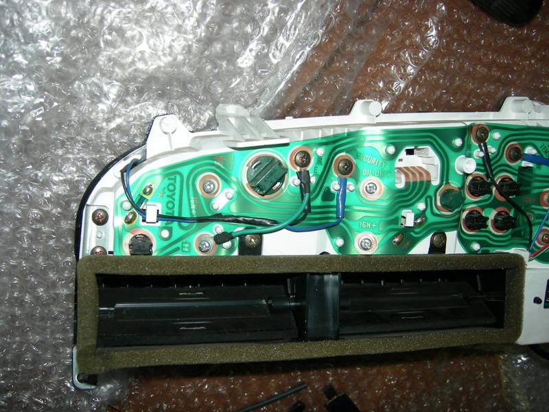

I remember reading in the past that the volt-meter was a direct replacement for the factory boost guage, like all that needed to be done was pop the old one out and put the volt-meter in. Not so. The boost guage has this control box mounted at the back of the cluster that sends the signals to the boost gauge (white and yellow wires). This must be removed.
The printed circuit board was also slightly different. The positive signal to the guage was unchanged but the ground circuit was different, and I had to add my own. (Green wire)
And the finish product!
HTH

KeithH;1185591 said:
Without the jumper you get no ground. No ground = no reading on the voltmeter. You had to do something.
I've heard others say this too. I'm wondering if some turbo boards had the ground built in like the N/A? I've only looked at 89+ boards so far.
Collin
KeithH
1,716
Portland, OR
Take a look at the area around the lower point of the jumper wire in the pics above. There are no paths leading to or from that point. This is one of the two connections for the voltmeter. If you don't create a full circuit then you won't get a working voltmeter.
