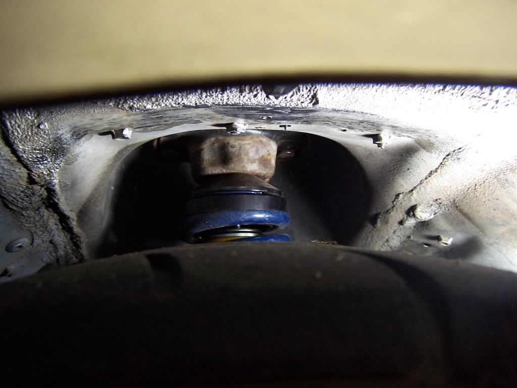

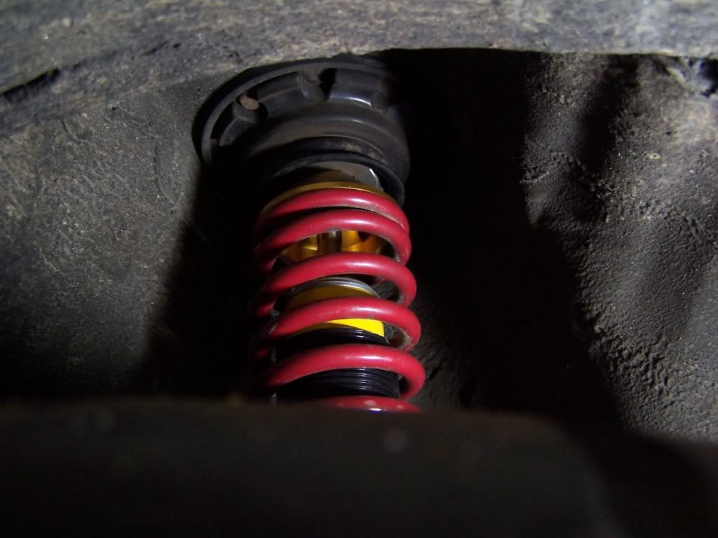

welp i spoke to soon. i had the car rather high up at the road course and didnt notice any issues but when i went to autocross this weekend i lowered the car to really where it needs to be and have almost no suspension stroke because of the factory mounts and the way i have them rigged. im going to make some custom mounts in the off season but i still will probably only have a inch or a little more of travel when i have the car at the height i run. the bilsteins are just to tall and there is no easy way to lower and get more stroke other than running thin upper mounts which is my plan now. also ive switched from the 400lb rears down to 350lb rear. this helps the car in bump and has allowed me to put my rear sway bar back on the higher setting for roll resistance. ill get pictures tommorrow morning since ill finally have a day without a test in school and show you the suspension stroke problems.

It's not because of the factory mounts. It's because the off the shelf damper body is too tall. There's only 4" of stroke on the front dampers, and you can't get the car to the right height without bottoming out the damper before you even start driving. If you're serious about the suspension, you'll ditch the front dampers for something else. Or just talk to me and I can get you set up with something and it doesn't necessarily mean that it will be expensive, there are lots of options out there.

front and rear respectivly. as you can see in the front the bulge in the middle of the upper mount is taking at least a inch of travel away from me. by making a flat upper mount with a spherical bearing in the middle i can get some of that travel back. in the back ive got a little more travel but the flat mounts will still buy me some travel. so thats my plan this off season. also need to get bump stops as im pretty sure ive already bottomed the two front shocks and probably blown them. i need to have them revalved anyway.

That's the problem I'm running into with mine, you lose some travel because the spring hat with solid or stock mounts add ~1.25" inch to the setup. If you could place an upper mount at the top of the spring, you'd close that gap. I've asked the seller of some ebay upper mounts about the bottom of those. If someone made a flat bottom or smaller OD ring on the underside of upper mounts, you could use them with 2.5" through stock springs.
