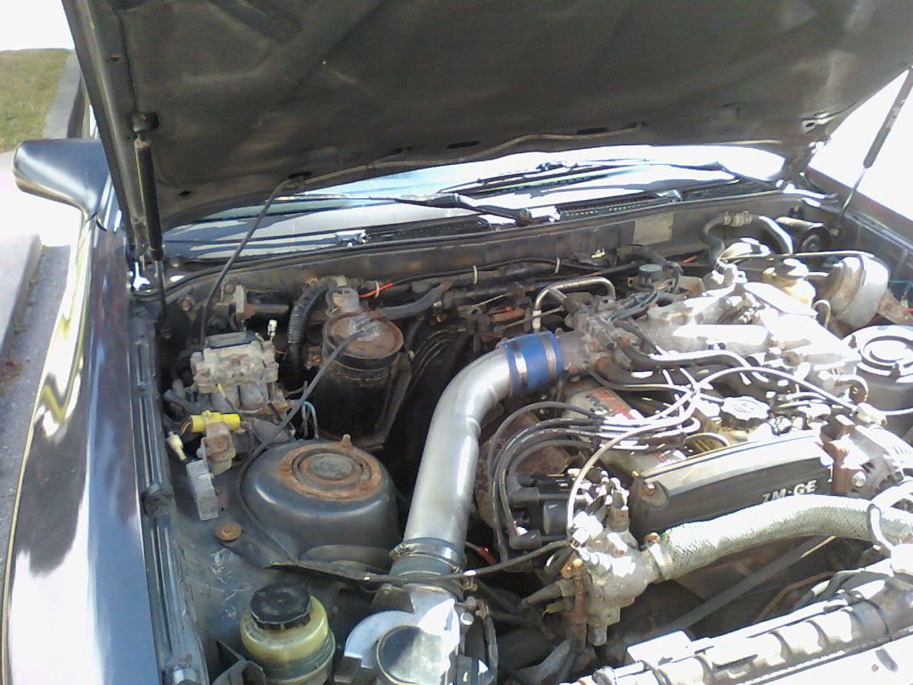

And just the overal construction and engineering of the car I think is the best. So I've reached the 275,000 clicks and I noticed rod nock getting louder and loosing rad fluid and white exhaust smoke and burning engine oil and loss of power and harder to start the engine already warm. to me it sounds like a broken head gasket. So this is a perfect excuse to swap in a newer engine right?

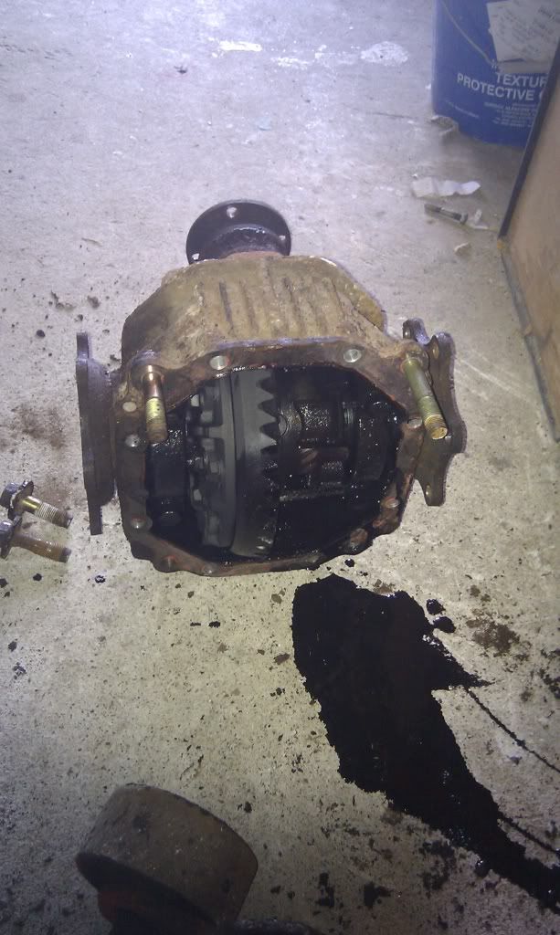

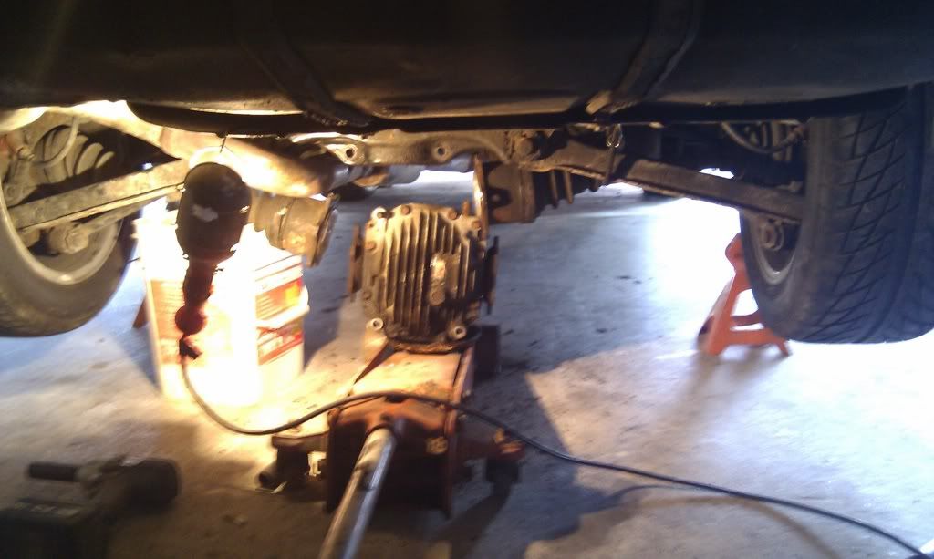

got old 4.3 lsd out, when i opened the plate to see the damage, it smelt like burnt chicken and very little oil came out. so the seals leaked oil faster than i could top it due to the breather getting dirty and clogged.

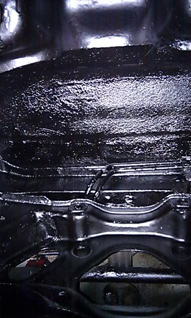

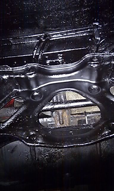

so after getting the diff out i bought some heavy duty detergent from partsource and cleaned up all the dirt and oils and sprayed on "asphalt in a can" because i doubt the undercoating guy can get above the diff.
