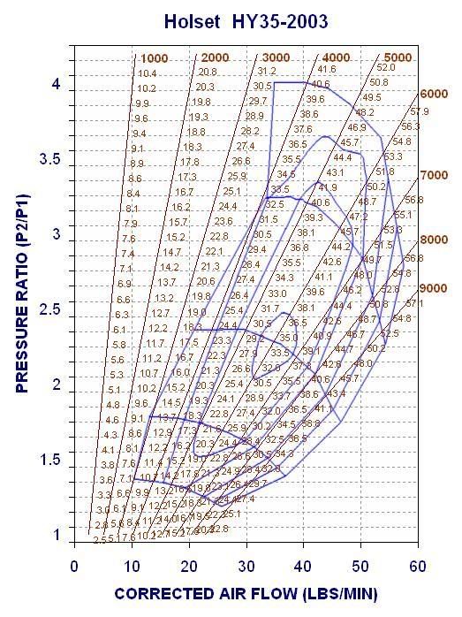

Ok here is the deal, im starting a new build and would like some info on these two turbos. Like how much power can be made with proper mods , the more info the better. Im trying to decide and compare these 2 turbos so i can choose one for my 7mgte.
1. Is a turbonetics T4-T04B
compresor:
T04b (v1) 63 trim, inductor=55.4mm, exductor 69.97mm, 0.60 a/r
Exhaust:
t4 flange, 74.6 trim, ind=73.5mm, exd=63.54mm, 0.58 a/r
2. Is a Holset Hy35,t3, 9cm exhaust claims to flow 57 lb/minute
CALLING MDC motorsports ;) (I know you gonna say holset but some info on the turbonetcs turbo like spool time, max power etc )

Here's the v1 / v2 map:
Heres the Holset map:
