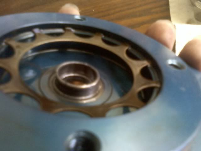

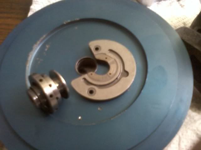

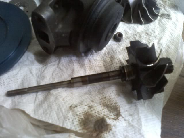

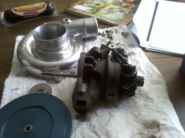

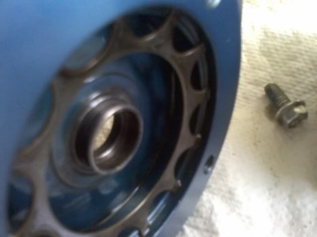

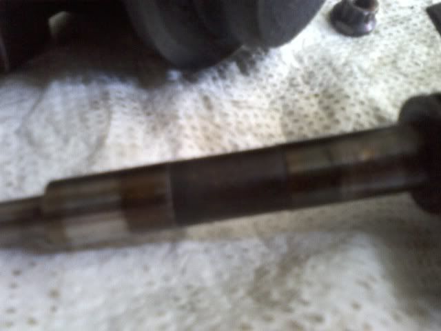

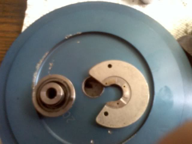

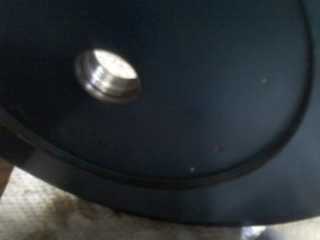

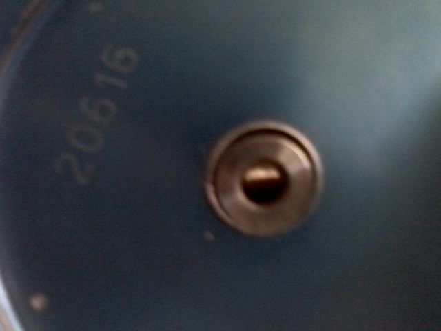

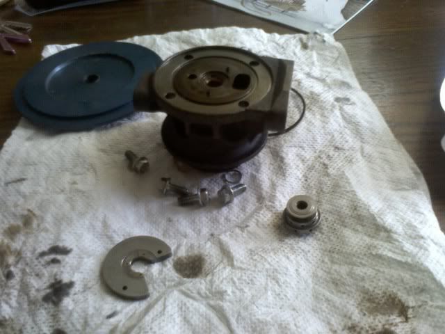

hey guys just a little update on that turbo, shaft and bearings are still good, just looks like the thrust bearing or what ever its called started to rub badly against the blue plate, would any one know how this could of happen? balance was off and made it vibrate and grind like that?
also the fins on the blade has very little scrapes, nothing to serious, and there are no in and out play
sorry for the quality, took it off my phone

Looks good bro, that 60 trim should have no problem making 400+ rwhp. I have made 430 rwhp and 430 rwtq at 18psi on a ct26-60 trim. I know you have a full 60 trim turbo so it will be more efficient. You can make around 375 rwhp with supporting mods at around 15psi on that 60 trim.

i mark up every thing, like the compressor wheel, the nut and the shaft, this will be like my 3rd turbo rebuilding, i rebuilt my ct-26 on my own and doing over 8psi and having no problem, and its a stock ct26, i got to ask on turbonetics forum about the turbo but i have to get some specs on the compressor wheel, so hopefully once i get my license back this week, i can go to a shop that i go and use a digital caliper reading or w/e its called, but so far this turbo is the easiest turbo that i have done, ct-26 was a pain in the ass with the giant snap ring they had for the compressor housing and trying to split it open for the first time in the middle.
its easy, just take your time, take pictures and mark every thing up and you will be all set
