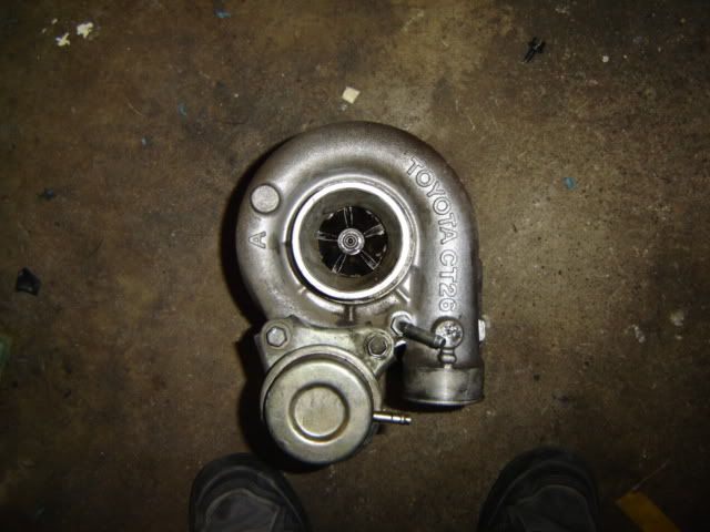

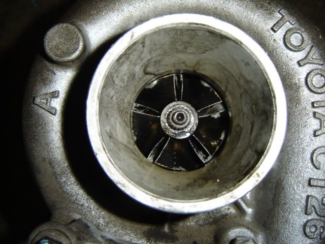

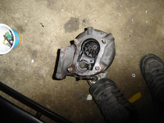

Well I got my old dieing turbo off, well actually it died about 45 minutes from home but i limped it home. It was all downhill, there was alot of costing :aigo:
Well here are the pics off the old turbo, enjoy.
Adjuster

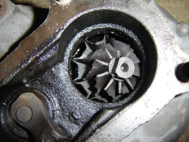

Just curious what PSI that stock CT26 died at? Or is it from coked bearings, and then the exducer side sheared off?
Does not appear it was spooled up to max when it failed, so I'm going with the coked bearings theory. (What does the oil drain side look like? I bet it's caked with coked/baked on oil deposits.)
