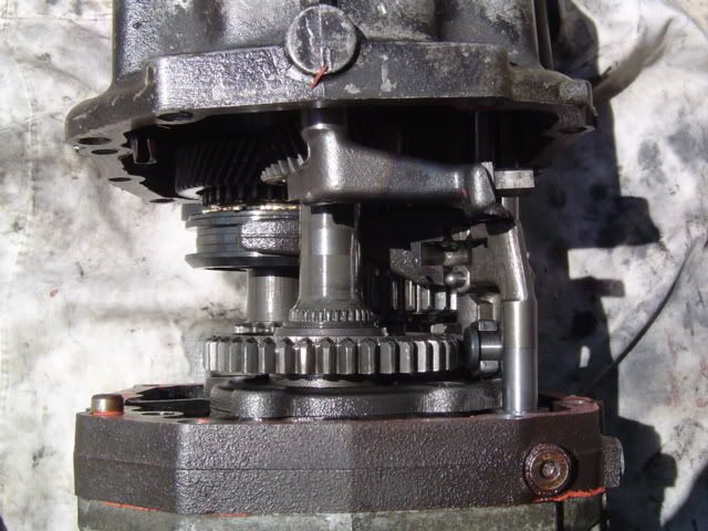

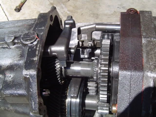

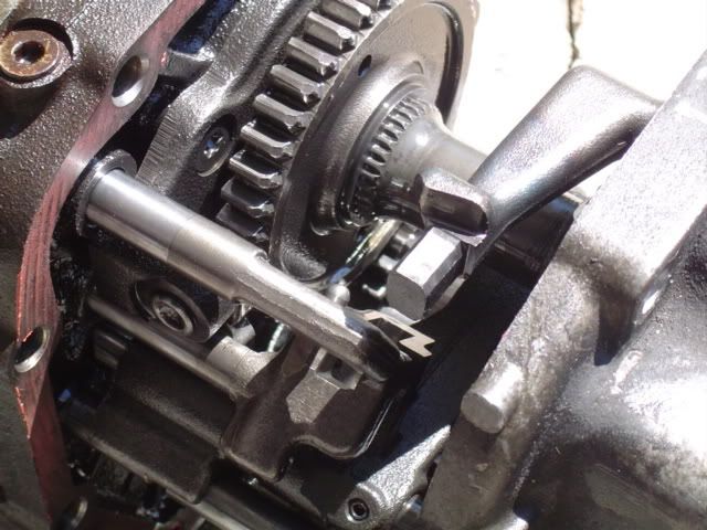

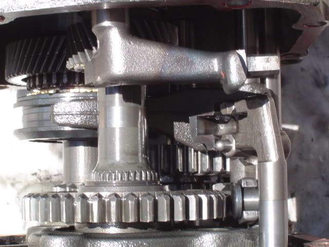

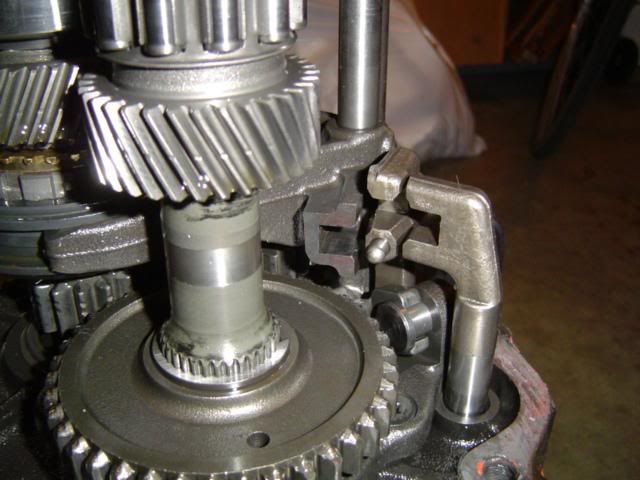

This is my w-58 tranny out of the my supra. So i'm putting it back together now that i forked out the washer that fell inside. I can't figure out how to reassembly the damn thing. lol HERE ARE SOME PICS!!!
cuel
Jan 8, 2007
1,536
Baytown, Texas
lol, its in gear(think its reverse). You should be able to pull that one up to line up with the rest. Don't pull to hard and pull it out, just enough to pop it up into neutral with the rest.
