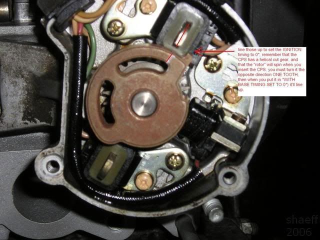

Backlash2032;1915766 said:
Step 1: Check to make sure shits on there right.
Step 2: Jump TE1 and E1
Step 3: Verify MIL is flashing without codes.
Step 4: Set the timing
Step 5: ?????
Step 6: Profit
It's not that hard folks..
Tweak that a little but well said. It ain't that hard at all...

Spoolncruzn;1915489 said:
ok with the bolt in the middle of the slot its like 25 btdc and i have 0 vac at ilde but my gauge is a pos
If it says 25 and you are in diagnostic mode, the CPS or engine timing is off. And 0 on the factory gauge means the vacuum line is unhooked.
